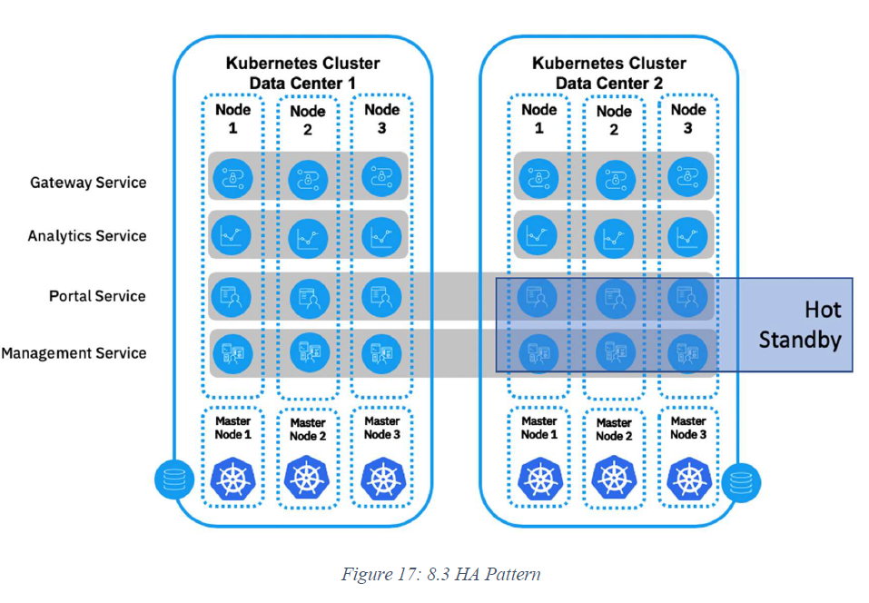

    Hi,
    We are using API Connect 10.0.5.x.
    Question 1:
    Just want to check by default does API Connect sync analytic data between below data center 1 and data center 2?
    If yes, how API Connect syncs data. If not, is there any way to sync data between data center 1 and data center 2?
    Question 2:
    Another question about analytic data in API Manager. Is it possible that API Connect filter out some analytic data such as payload? Because customer feels the analytic data size is too big, they want to capture only certain important analytic data.
    Question 3:
    Is API Connect using Java? If yes, what Java version it is using?

  • 6.  RE: Analytics data synchronization between two data center
    Posted Thu February 01, 2024 03:58 AM
    Analytics data will definitely not be synced across data centers - the amount of data involved in analytics is exponentially more than any other component and keeping terabytes of data sychronised between two data centers is simply not feasible.
    The pattern you posted a screenshot of shows 2 gateway services, one in each datacenter. Each of those gateway services has its own local analytics service, so there definitely wouldn't be any synchronisation there since they are two completely different services.
    Chris Dudley
