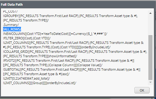

    We have encountered this issue when creating detail YTD reports and I was wondering if others have also encountered this issue, and wanted to know if we were doing something wrong.  When we are in a particular month, let's say JULY 2015, and looking at PC costs by employee within the organization. The raw data has all employees, their PC inventory # and the current depreciation amount of that PC (it is a monthly file that gets produced each month end). So a manager can filter by their cost center and get their total PC charges for the current Month, and the employee detail that makes up the charges. The current month detail always matches the total charges.  The YTD total however does not match the YTD detail.  When I dig into it, this is due to an employee that existed in the beginning of the year, had PC charges JAN-APR but no longer has a charge in JULY.  So when your in the month of JULY 2015  the YTD detail only shows YTD detail for the people on the July raw file, even though the former employees did have charges in JAN-APR and the YTD KPI has those charges included (as it should).  How do I get the detail to match the YTD total?

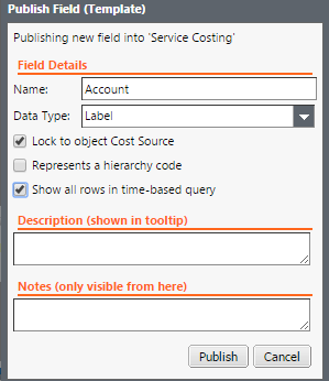

    3. Drag the field you want to see all values for into the Rows section (NOTE: If you already have a field with this value in it you can do the below steps from that table).
    4. Right Click the field and click Publish
    5. Select the Grouping (Perspective) you want to save the field in
    6. Select the check box titled "Show all rows in time-based query"
    7. Click Publish

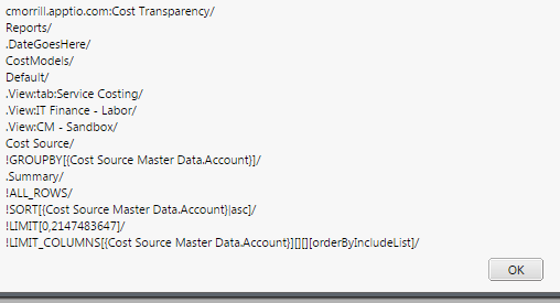

    You can quickly check if this worked by right clicking on your data table and selecting Show Full Data Path.
    When the full data path loads look for the phrase "!ALL_ROWS"

    Thanks Craig, Will log issue with Support, as you can see from the screenshot the fields were published and the data path shows "!ALL_ROWS".  However when you extract the data to excel the employees that fell off the list no longer show up in the YTD detail report even though they have YTD cost.
