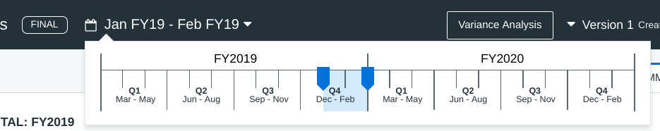

    Use the date selector at the top to narrow down the comparison window to just the months you'd like to see:
    #ApptioPlanning(ITP/ITFMF)
