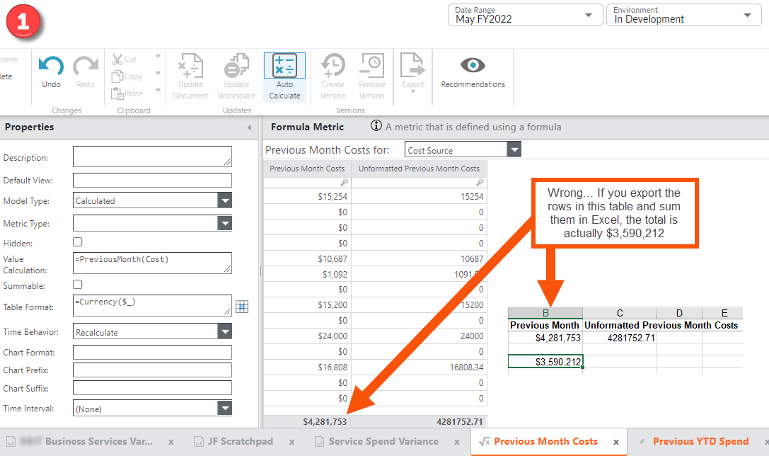

    I had created a simple metric to show the previous month's cost using =PreviousMonth(Cost) and added it to a report.
    Later, I noticed it wasn't summing correctly.  It would show the total at the bottom, but when I exported it to Excel and summed it there, it came up with an entirely different number.
    Usually, the first thing I think of when something isn't summing correctly is I'm probably not seeing 'all rows in a time based query'.
    I also published the metric to a perspective and made sure to enable the 'Show all rows in a time based query' option and used the perspective in place of the metric on the report.
    Still not summing correctly.  What gives? πŸ€·β€β™€οΈ

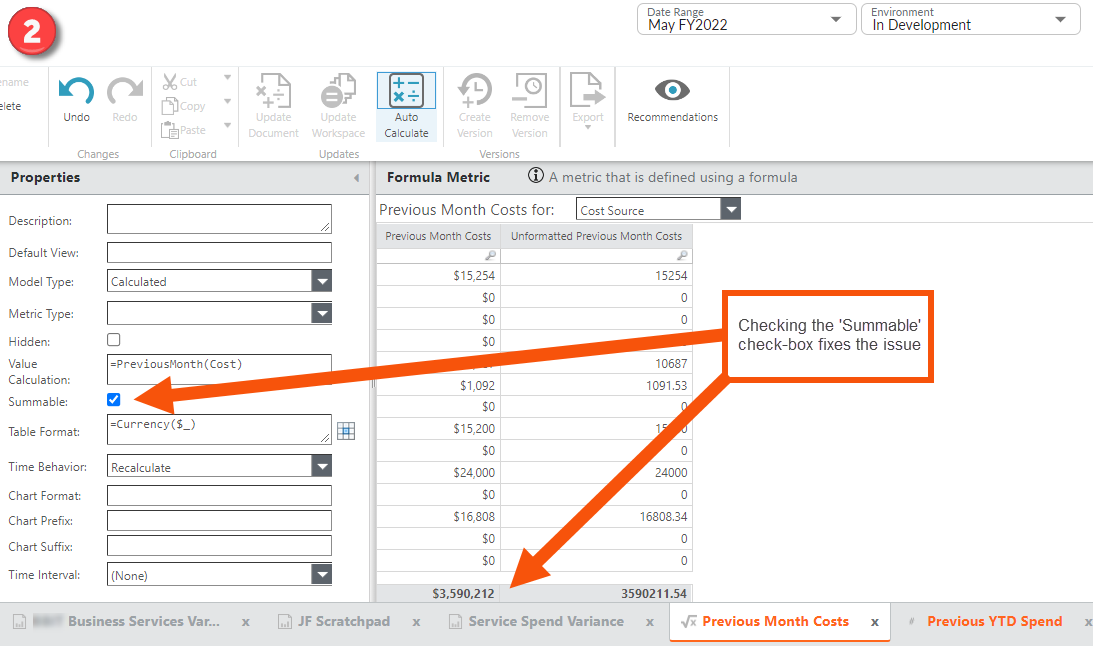

    After looking back at the metric itself, I noticed the 'Summable' check box was not checked.
    I checked the box and refreshed the data in the metric and lo and behold, there was the correct total!
    You probably already knew this, but for those of us who didn't, sharing is caring as they sayπŸ˜‰

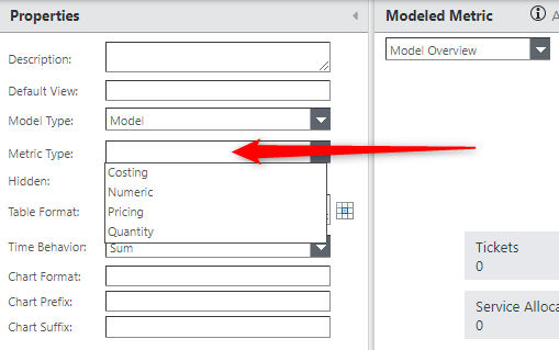

    Something I learned the hard way is that we should select an option in the Metric Type box (for modeled metrics, that is):
    In my oldish reference PDF (TBM Studio 12.8.1 Administrator's Guide-I downloaded it from the jiveon community years ago), it says:
    QUOTE
    Multi-currency has the following restrictions:
    β€’ In reports, only values based on modeled metrics of Costing and Pricing types can be displayed in the currency chosen by users. All other values will be displayed in the base currency or in the currency to which they have been converted
    UNQUOTE
    Not sure what the effect is under other conditions, but I usually select Costing, except for one-Count of Actual Servers-which I selected Numeric, for obvious reasons.
    I definitely have stumbled upon the Summable checkbox issue at some point.
