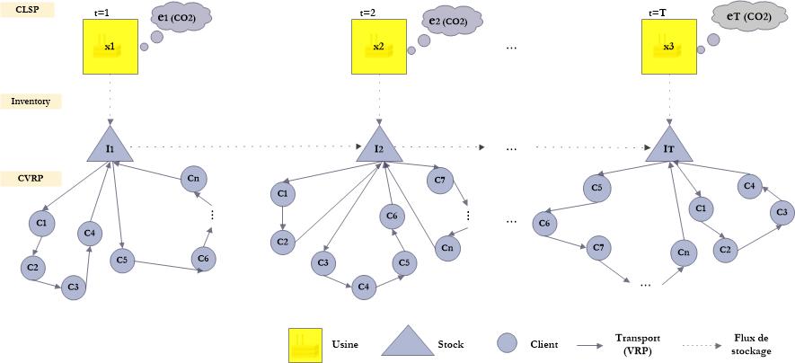

    Originally posted by: ZakariaChekoubi
    Good evening everyone.
    I am a beginner in CPLEX.
    I have to model a lot sizing problem integrated to vehicle routing problem. Indeed, my problem is similar to the problem PRP (Production Routing Problem) except that my customers do not have inventory. Thus for the vehicle touring party each vehicle must leave the depot (which contains the batches produced) to serve all the customers then return to the depot.
    Hereinafter the schema explaining my problem. I have considered carbon emissions at the production level. Indeed, each quantity produced emits an amount of CO2. The latter must not exceed the authorized amount of carbon emissions per period.
    The problem is therefore to find the optimum quantity to produce as well as the optimum tours to consider.
    I need your please. I'm waiting impatiently for your answer.
