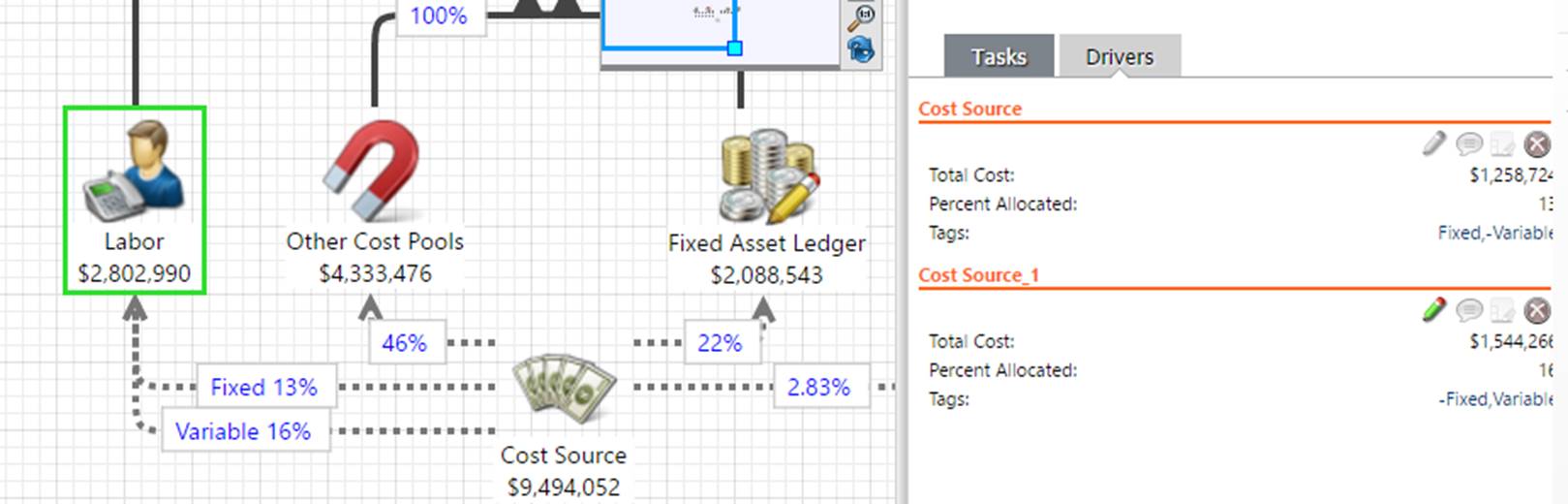

    My object drivers at tagged as following:
    Fixed, Unrecovered and Variable as my cost source.  Then in the next object I try to tag the driver as Fixed,-Unrecovered or "Fixed,-Unrecovered" and the model still shows the full amount allocating from both tag drivers.  I've even tried creating a second allocation line and tagging that driver as Unrecovered.
    Maybe there's a piece I'm missing and any help would be great.
    Jeff

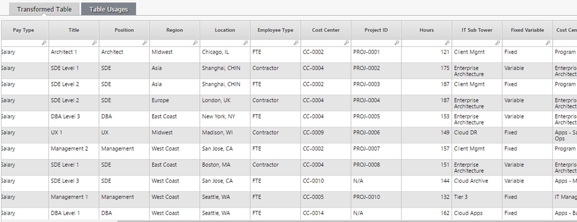

    So you have a column in your Labor dataset that says "Fixed/Variable"?  Can you screenshot this?
    Jeff
  • 9.  Re: Using tags in an allocation
    Posted 12/07/16 03:34 PM
    Jeff,
    Here you go! Second to last column.  Yeah the tags are tricky depending on what requirements are for how they can change as they go up the model

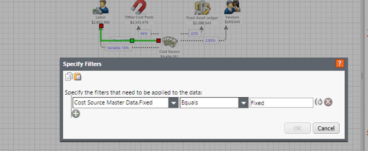

    What does your allocation lines look like?
  • 11.  Re: Using tags in an allocation
    Posted 12/07/16 04:00 PM
    Jeff,

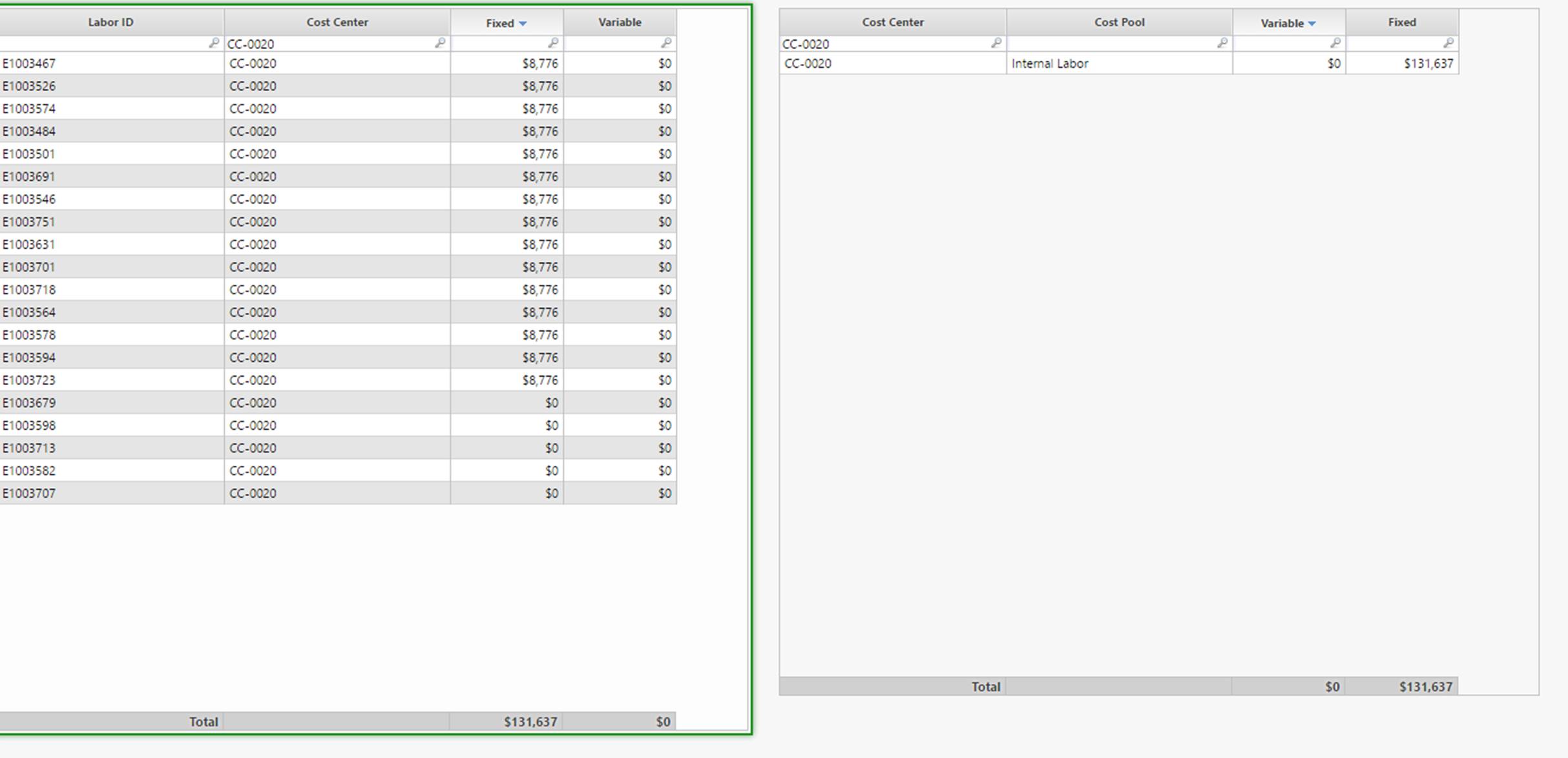

    I didn't actually build that part of that in the dataset (Labor) as the rules for what's Fixed vs. Indirect, but it would be a formula column that would look at Employee Type to determine whether they were Fixed vs. Variable.  I just expanded out the Labor object for Fixed vs. Variable and then on my allocations used the Some Filter to only go from Cost Source = Either Fixed Variable depending on which one I wanted in the allocation.  Then I just leverage the fixed \ variable column as metadata for the granularity of my key.

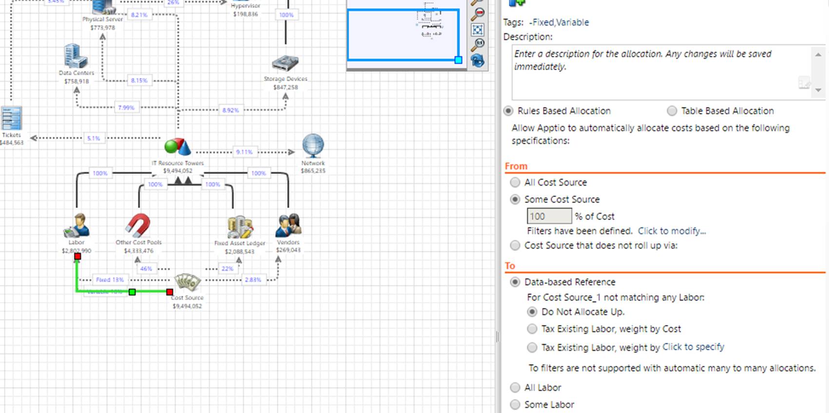

    Ok, I understand what you did.  However, it doesn't look like you are using the tags to filter the data up the model as I was hoping you did or what I am trying to do.
    Here's what I understand from what you have shown me (please correct me if I'm wrong).
    The cost source drivers are flagged as Fixed/Variable.  You most likely have keys in both Labor and Cost Source object and that is controlling how fixed is flowing to FTE and variable to Contractor.  Because you filtered your From section, this is whats controlling your allocation line only to send Fixed dollars.  Therefore your tags are not doing the filtering.
    Not sure what the whole "Fixed,-Variable" tag is doing.  Even the reporting you are doing should work without this.

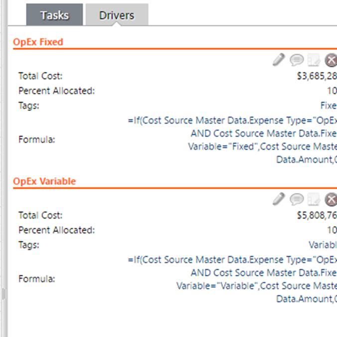

    I'm trying to get the allocation to filter based on the tag.  That way I can send only the tagged dollars through that allocation line.  That way I can create one allocation strategy for Fixed and the other for Unrecovered.  I also don't have the detail in my cost source that is detailed by Fixed/Unrecovered.  That's in another dataset and I'm using the driver's formula to determine the amount that is Fixed/Unrecovered.
    Jeff
