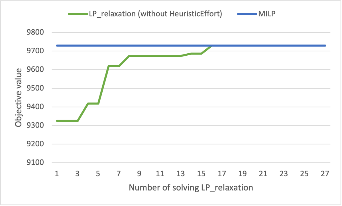

Thank you for your helpful response! Your suggestion worked perfectly. By setting CPXPARAM_MIP_Strategy_HeuristicEffort = 0, we can now use CPLEX as a pure cutting-plane algorithm to solve MILPs.
For reference, I have attached a new figure showing the objective values of all LP-relaxation problems generated by CPLEX during the solving process. As described in my previous reply, the green line represents the objective values of the LP-relaxation problems, while the blue line denotes the optimal objective value of the original MILP. The green line is now monotonically increasing and eventually reaches the blue line, suggesting that CPLEX is effectively utilizing a pure cutting-plane algorithm.

While I agree that it could be very difficult to make CPLEX solve an instance of a model only by cutting planes and retrieve them all, there are a few other attempts to be done.
Note: I don't know how CPLEX works actually under the cover. Anyway, you should also look at heuristics: at node 0 (and sometimes at any node) CPLEX will run heuristics (implying B&B) which could find solutions. There are parameters to avoid them. I would add at least CPXPARAM_MIP_Strategy_HeuristicEffort=0, which should avoid the usage of heuristics even at node 0.

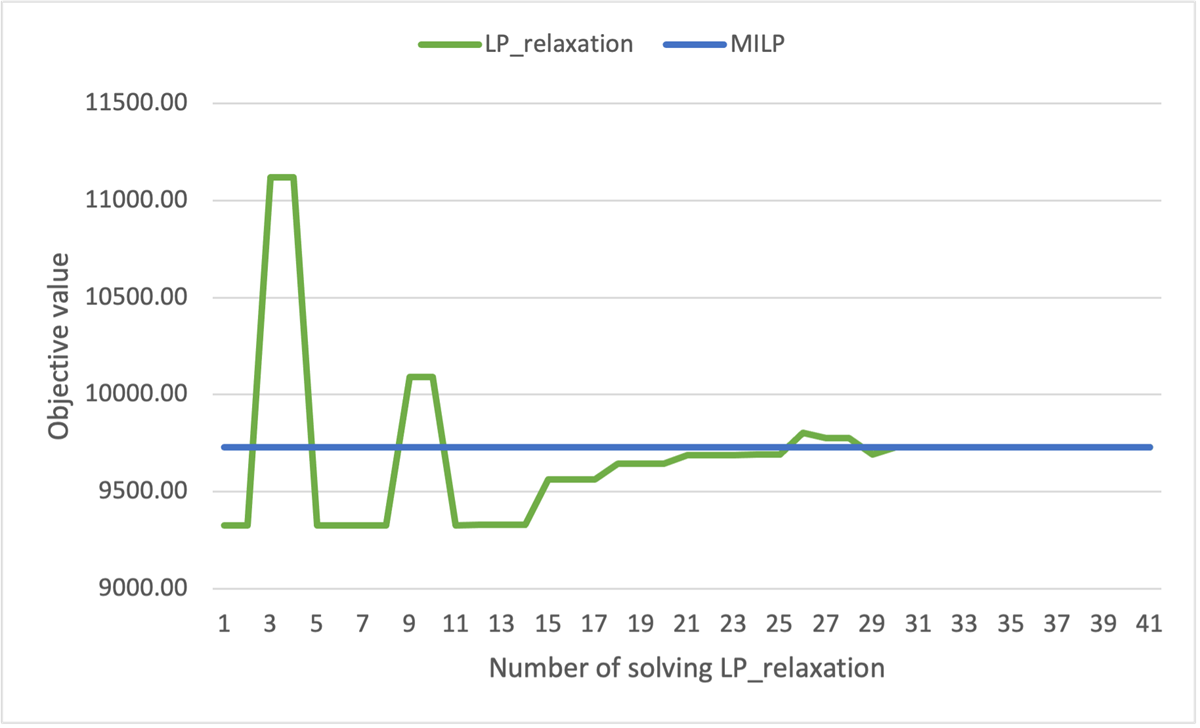

Thank you for your response! Your suggestions have been very helpful, and we can now use CPLEX to solve the MILP quickly. However, it seems that the way CPLEX solves the MILP is not purely through a cutting-plane algorithm. Let me describe the new issue I'm encountering.
To solve a MILP, CPLEX generates a series of LP-relaxation problems and solves them one by one until it obtains an optimal solution that satisfies all integrality constraints.
Following your suggestions, I configured the CPLEX parameters as follows:
· CPXPARAM_MIP_Limits_Nodes is set to: 0
· CPXPARAM_MIP_Cuts_Gomory is set to: 2
· CPXPARAM_MIP_Cuts_MIRCut is set to: 2
· CPXPARAM_MIP_Cuts_Disjunctive is set to: 3
· CPXPARAM_MIP_Limits_CutsFactor is set to: 100000.000000
· CPXPARAM_MIP_Limits_CutPasses is set to: 100000
· CPX_PARAM_PROBETIME is set to: 0.000000
We are now solving a minimization problem. Figure 1 shows the objective values of all LP-relaxation problems generated by CPLEX during the solving process. The x-axis represents the number of LP-relaxation problems solved by CPLEX, while the y-axis represents the objective value of the corresponding LP-relaxation problem. The green line represents the objective values of the LP-relaxation problems, and the blue line is the optimal objective value of the original MILP. If CPLEX were using a pure cutting-plane algorithm, the green line would be monotonically increasing and would eventually reach the blue line. However, it is unusual that the objective values of some LP relaxations (e.g., the 2nd and 3rd ones) are higher than the original MILP.

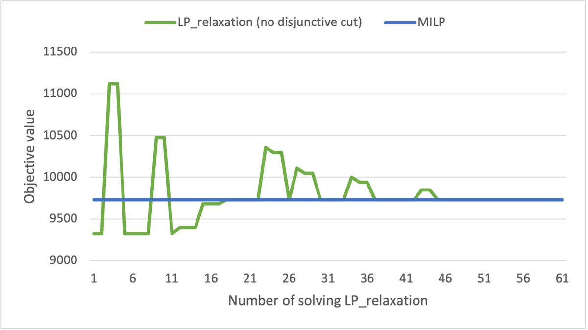

Considering that disjunctive cuts may function similarly to branching, I disabled the generation of disjunctive cuts:
· CPXPARAM_MIP_Cuts_Disjunctive is set to: -1
Figure 2 shows the objective values of all LP-relaxation problems generated by this new setting of CPLEX during the solving process. However, the objective values of some LP relaxations are still higher than the original MILP.
Do you know why this phenomenon occurs? How can we configure CPLEX to work as a pure cutting-plane algorithm? Any pointers you could provide would be greatly appreciated!
