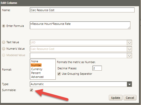

    I've created a report table and instead of the total column adding up the values in the specific columns it's completing the calculation of the columns:
    An example of the columns are as per below:
    Resource Rate      Resource Hours      Resource Cost
          £100                           28                        £2,800
          £150                           32                        £4,800
          £190                           17                        £3,230
    I would expect the totals to be:
    Resource Rate: £440
    Resource Hours: 77
    Resource Cost: £10,830
    Instead the Resource Cost is showing as £33,880 - Total Resource Rate x Resource Hours - how can I swap the totals values to show what I'm expecting?

    Best Answer
    Posted 09/26/17 07:45 AM
    Support rectified the issue - they edited the two cost columns by making them numeric and summable - the issue is now solved. Thanks @Michael Moulsdale for your help
