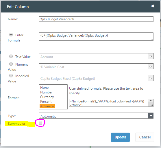

    Assuming this is a calculated column on a report, two things I would check are:
    1) The "Summable" check-box is not accidentally checked in column properties (it should be unchecked).
    2) The other columns or metrics on which the formula is based are also not summable.

    Short answer: This is something that has been fixed in later version as you saw when you checked the reference application that was on CT Version r12.6.2a.
    So I'd recommend just getting upgrading to the latest version and you should see this work correctly.
    Longer answer:
    In r12.5.1.1 this report is using If statements in the Budget Variance % calculation formula. e.g If(Budget=0, 0, BudgetVariance/Budget)
    As I understand right now this can cause issues with totals to calculate as a Sum as you saw despite the Summable box not being ticked.
    In later versions this looks like its been fixed by (as shown in Jaitabh's screenshot) updating the formula to no longer make use of the If statement but rather use 0+ instead to handle the possibility of a 0 divisor.
