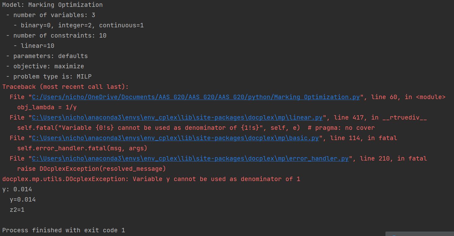

    By the way, after getting the result for y, I would like to put a new equation : obj_lambda = 1/y .
    When I wrote the code after the cplex as follows, there is error as in the next screenshot.
    In this case, is there any way for me to add the new equation? Thank you.

    obj_lambda = 1/y
    Error message
    ​Thank you.

  • 5.  RE: The CPLEX does not provide the expected result
    Posted 08/09/22 10:15 AM
    y is always a variable. To get its value after solve, you have to use y.solution_value
    So you should do the following?
    obj_lambda = 1/y.solution_value
