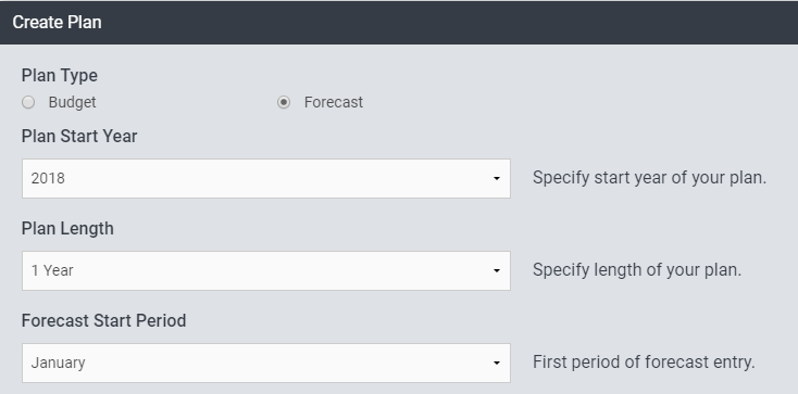

    Hi everyone,
    I have previously created a discussion about forecasting and I am very new to Apptio. I am now tasked to roll out a multi year forecasting using the ITP and I am still taking my little steps to get to the process.
    Objective of creating these plans  is for the cost center owners to adjust their budgets month over month reflecting their expected additional/reduction costs, etc.
    Given facts:
    1. Created a forecast test plan starting July 2018 with baseline FY2018 Budget.
    2. Actuals are imported from external source from January - May 2018
    3. No adjustment are made yet to the Plan.
    4. Plan is on the "NEW" state.
    5. Plan length is set to 1 year
    This is how it looks like now :

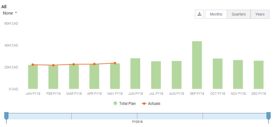

    Observations:
    1. Actuals and Budgets matches from Jan - May 2018. My thoughts is that because I have actuals through these months, this replaces parts of my budget. To compare budgets to actuals, I can just open the FY2018 Budget plan and set Compare to : Actuals.
    2.  In the graph, we can clearly see that forecasting simply means Actual spend + remaining budgets in the year
    3. The time scale doesn't have 2019 even if I set the plan length for 1 year.

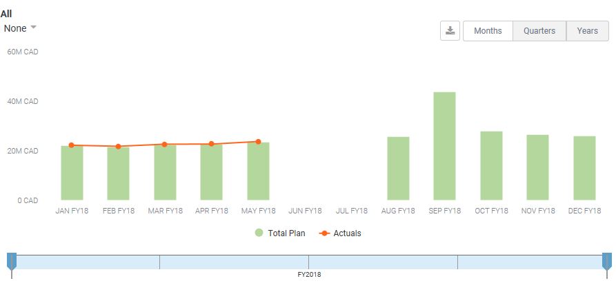

    Another thing that I did is to create an August test plan (baseline July 2018 test forecast). Plan year is set at 1 year.
    This is how it looks like:
    Observation:
    1. Because I don't have actuals from June 2018 onwards, the graph was blank for June and July.
    2. The time scale doesn't have 2019 even if I set the plan length for 1 year.

  • 2.  Re: Test Plan: Multi Year Forecasting
    Posted 09/06/18 12:18 PM
    Hi Rose Ann,
    In regards you're questions, let me see if I can help.
    1.   Why can't I see 2019 if I'd selected July 2018 as my starting point?  This would be do to the fact of when you create the plan you most likely selected the Fiscal Year of 2018 and set that plan length to 1 year, you'd have to set the plan length to 2 years if you wanted to see 2019 in you're chart above.

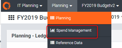

    2.  If I have to import actuals for June where should I need to import it? in the July test forecast plan or in FY2018 Budget (baseline)?  In ITPF you'd go to the Spend Management Tab and import the actuals there.  However, once you import those actuals they will not automatically show up on your forecast.  You'll need to create a new forecast.
    If you have actuals through June, you'd create you're forecast to start in July as July would be the first month that you'd like to forecast.

  • 4.  Re: Test Plan: Multi Year Forecasting
    Posted 09/06/18 12:52 PM
    Rose,
    No worries.  In regards to the actuals, they will be (the actuals) will be only imported into the Spend Management section.  Once you have imported the actuals you'll create the forecast for the next period if you do a monthly \ quarterly forecasting process.
