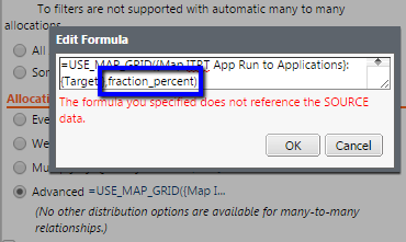

    I have used this couple years ago; it works better if the tables backing the source and target objects are not big. I think that a better alternative is to use the Use_Map_Table() allocation from the advance allocation tab. To use this method, you will need a mapping table that has the identifier of the source object, the identifier of the target object, and a weighting column.
  • 3.  Re: Table Based Allocations
    Best Answer
    Posted 06/18/15 04:58 PM
    The process wasn't quite as intuitive as I would hope for.  Since we were using decimals to represent fractions it made for an extra step.
    First, we created the allocation, including the mapping tables, using the UI.  We then uploaded the correct allocation grid into the new table.  The process of uploading to this table reset the default allocation strategy to Manual Weight.  We had to change that back to Manual % which got the allocation to work, but, at 1/100th of what was expected.  To fix the percentage we had to switch to Rules Based Allocation and update the Use_Map_Grid formula at the bottom of the pane from using 'percent' to 'fraction_percent'.  The two biggest takeaways were setting the Default Strategy and updating the Use_Map_Grid formula.
