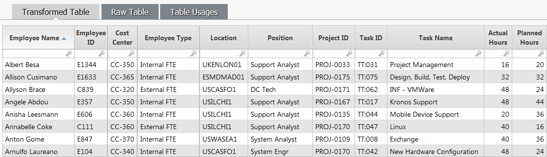

    I am lucky enough to have highly detailed time tracking data covering all major IT projects.
    Here's a peek at my Time Tracking Stage table, and it's large: around 450,000 rows per month:
    The Employee ID values aren't part of the original data. I map these in by looking up the Employee Name in my labor data. But if there is no valid entry in the labor data, I want to fallback to a default Employee ID value of "E0000" instead.
    Here is the column formula involved:
    Employee ID = If(Lookup(Employee Name, Labor Roster, Labor Name, EID) != "", Lookup(Employee Name, Labor Roster, Labor Name, EID), "E0000")
    My Labor Roster data table is also relatively large: 40,000 rows per month.
    I've noticed this transform table seems to take a bit of time to calculate.
    Why is it taking so long, and is there anything I can do to speed things up?
