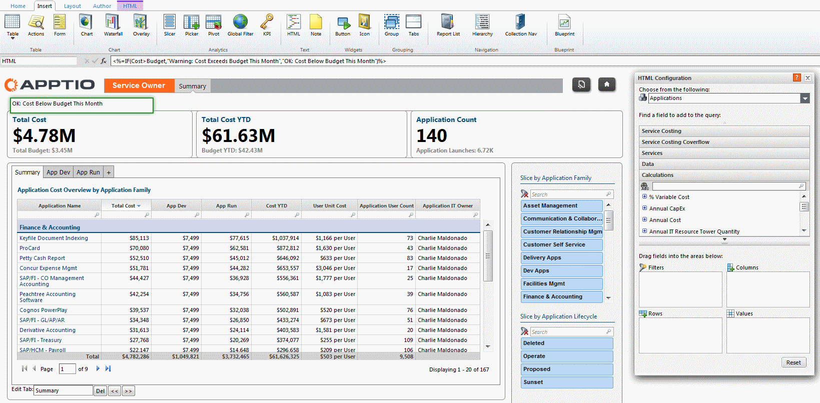

    I'm working on an application cost overview report.
    Here's what I've got so far (click to enlarge):html_component.png
    The green highlighted box shows my selected HTML component, which I added by clicking Insert > HTML from the Ribbon.
    It's a message to indicate whether this month's costs are above or below budget.
    If you look closely at the HTML component's function area just below the Ribbon, you'll see:
    <%=IF(Cost>Budget,"Warning: Cost exceeds budget this month","OK: Cost below budget this month")%>
    This month's actual application costs are $4.78M.
    And this month's budgeted application costs are $3.45M (see top-left KPI, below total cost).
    ...but the HTML component I created displays the wrong message: it says Cost is below Budget.
    How should I adjust the HTML component so it shows the correct message?

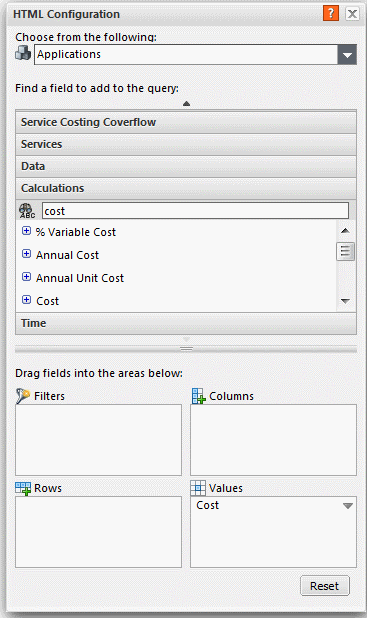

    Two answers to this question...
    1. this is a top level report and therefore the HTML component will not have an object or model context by default.  you must set this context for the component to evaluate as expected

    Assuming this is a from-scratch report, I took your advice and looked at the HTML Configuration dialog to the right of my report table.
    Its top-of-dialog context says Applications, but no fields or metrics have been dragged down to the bottom four areas (Filters, Columns, Rows, Values) - so this HTML component doesn't know which object context (if any) to use.
    My formula uses Cost and Budget, both of which are metrics.
    To set the context for this report component, I found Cost in the Calculations perspective and dragged it down to the Values area:
    ...and then my formula worked correctly, showing the warning message.

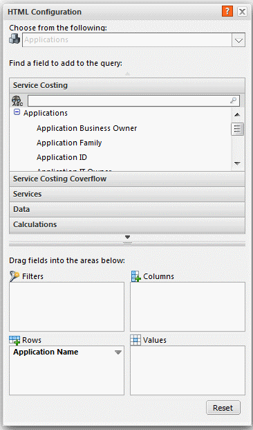

    Even better: drag a locked field down to the Values area. This will gray out the object context area (top of configuration dialog) to denote that the HTML component is now locked to the Applications object:
    ...in the example above, I dragged the Application Name field, which was published in the Service Costing/Applications perspective and locked to the Applications object.
    My formula still works correctly, but now I have reduced the chance of inadvertently changing the context next week when I work on this report some more.
