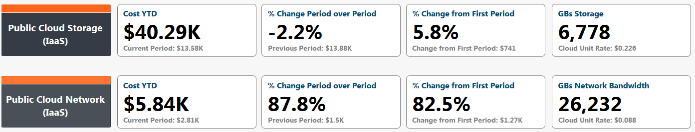

    Here is a small section of a Cloud Service Provider Summary report I'm building (click to enlarge):
    I like the eight KPI components, but with so many, it would be nice to format the first one in each row (the Cost YTD) such that it stands out a bit from the other three in the row.
    But when I edit the report, select the KPI, and examine the Ribbon options and the KPI's Properties, I'm not seeing this type of flexibility.
    Is it possible for me to somehow override the default KPI display characteristics (font size/color, border size/color) or otherwise create a KPI that looks a bit different?

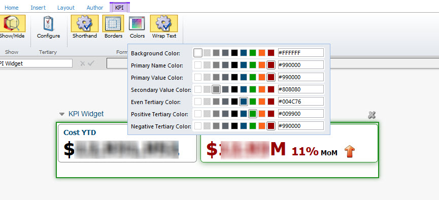

    hmm... is this a trick question? or maybe I'm way over thinking it... Are you saying you can't see the KPI option on the ribbon or that when you click on the KPI in the ribbon the options to change colors are grayed out?
    If you select the KPI group on the reporting surface you have to click on the KPI in the group in order to edit the color and background.
  • 3.  Re: [+] STUMPER: Fine-tune KPI in report
    Posted Thu March 12, 2015 04:34 PM
    It turns out this is a trick question of sorts: the options you're seeing were added in version 11.4 of the software, but some customers may still be using a previous version. When they select KPI, they don't see color options.
    Still though, the options you cite include border toggle (on/off) and text color, but not border color/width or text size. Any ideas on whether or how those characteristics can somehow be altered?

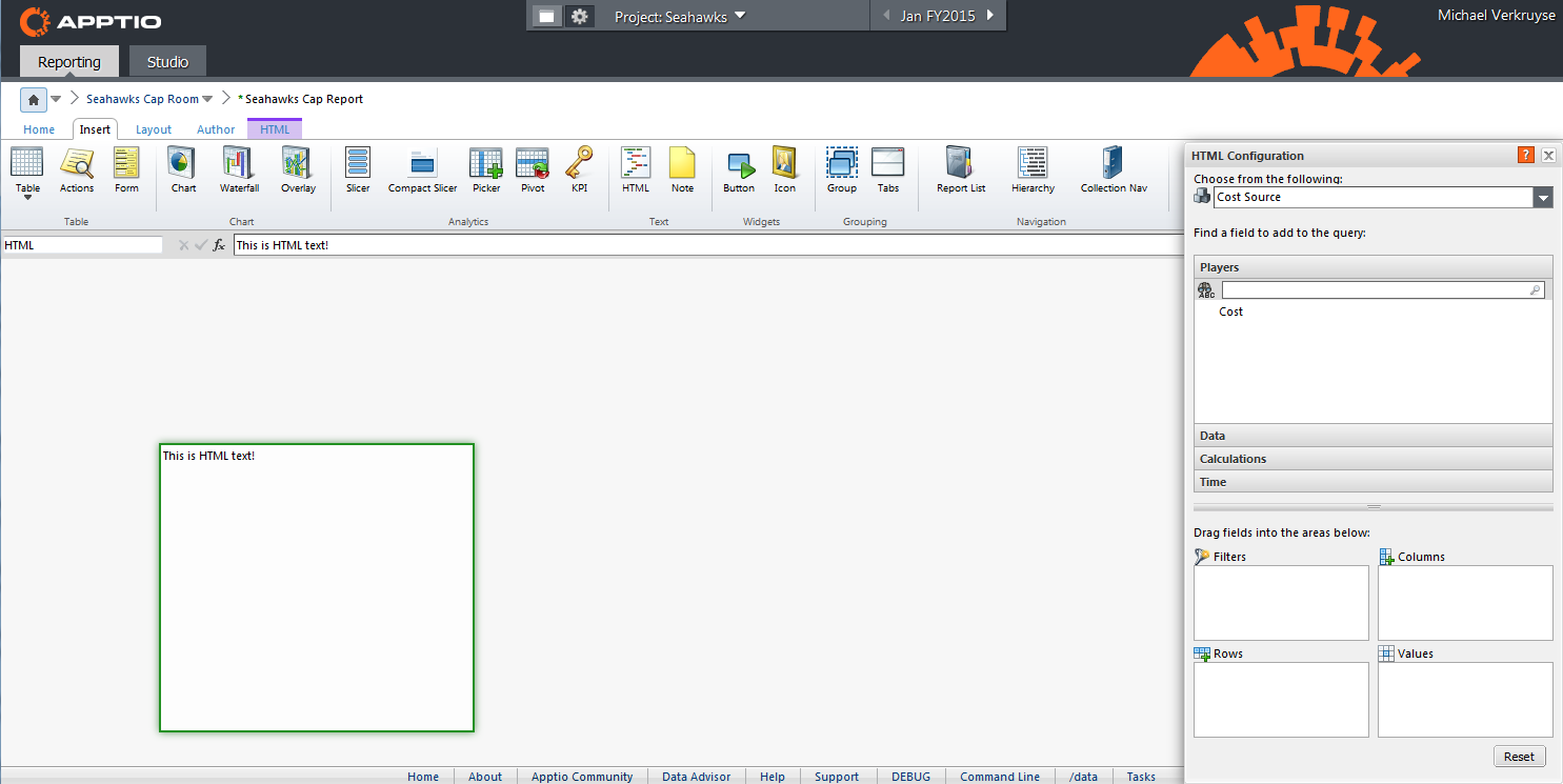

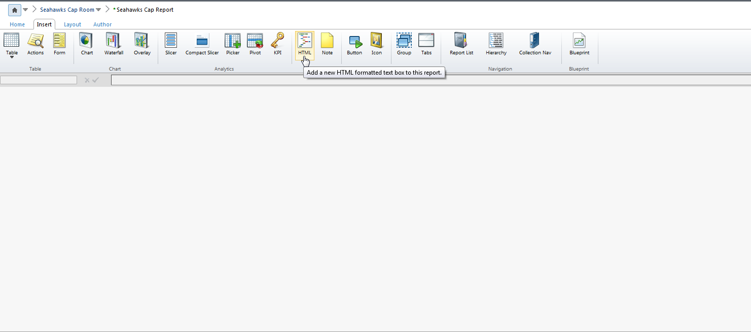

    In the reporting surface, first click on the "HTML" icon in the insert tab to add an HTML-editable frame.
    2015-03-12 15_42_53-Apptio - (mverkruyse.apptio.com) Seahawks - Seahawks Cap Room _ Seahawks Cap Rep.png

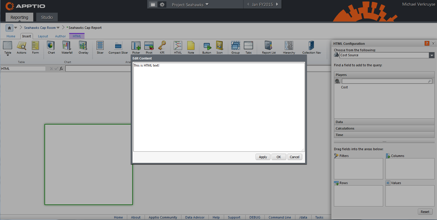

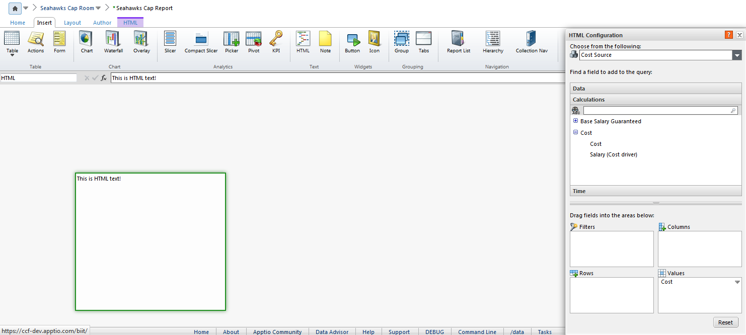

    You can add plain text to the content box, and Apptio will interpret it as normal text:
    2015-03-12 15_43_41-Apptio - (mverkruyse.apptio.com) Seahawks - Seahawks Cap Room _ Seahawks Cap Rep.png
    2015-03-12 15_43_56-Apptio - (mverkruyse.apptio.com) Seahawks - Seahawks Cap Room _ Seahawks Cap Rep.png

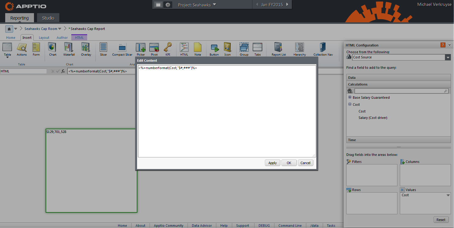

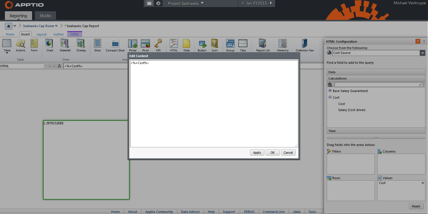

    However, we can also use data from our Apptio project in our HTML frame. Notice that I've pulled down the "Cost" calculation into the values box, this will allow us to use the metric within the HTML.
    2015-03-12 15_45_52-Apptio - (mverkruyse.apptio.com) Seahawks - Seahawks Cap Room _ Seahawks Cap Rep.png
    To do so, encompass the value that you wish to include as follows:
    <%VALUE YOU WISH TO INCLUDE%>
    Notice in the HTML box behind that the expression has evaluated as it would appear in the model for the selected period.

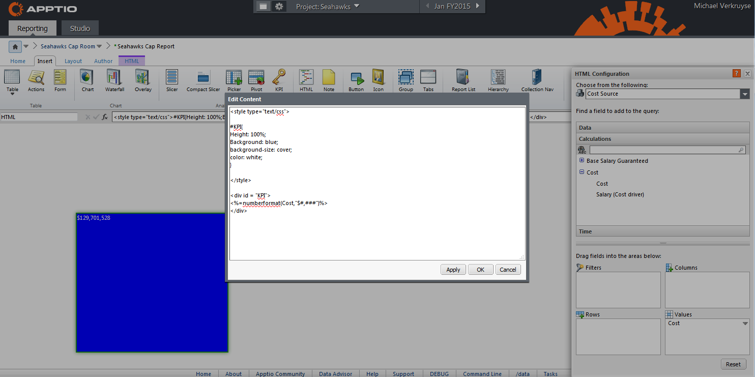

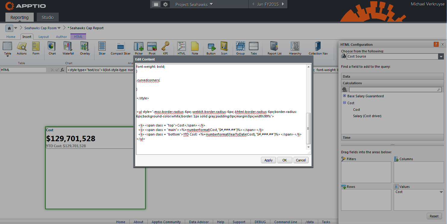

    Once you've formatted your value as desired, you can modify the HTML frame as you would a typical HTML document, including using CSS.
    2015-03-12 15_52_53-Apptio - (mverkruyse.apptio.com) Seahawks - Seahawks Cap Room _ Seahawks Cap Rep.png
    A few modifications is all it takes to bring your HTML frame into the format of an Apptio KPI:
    2015-03-12 16_43_23-Apptio - (mverkruyse.apptio.com) Seahawks - Seahawks Cap Room _ Seahawks Cap Rep.png

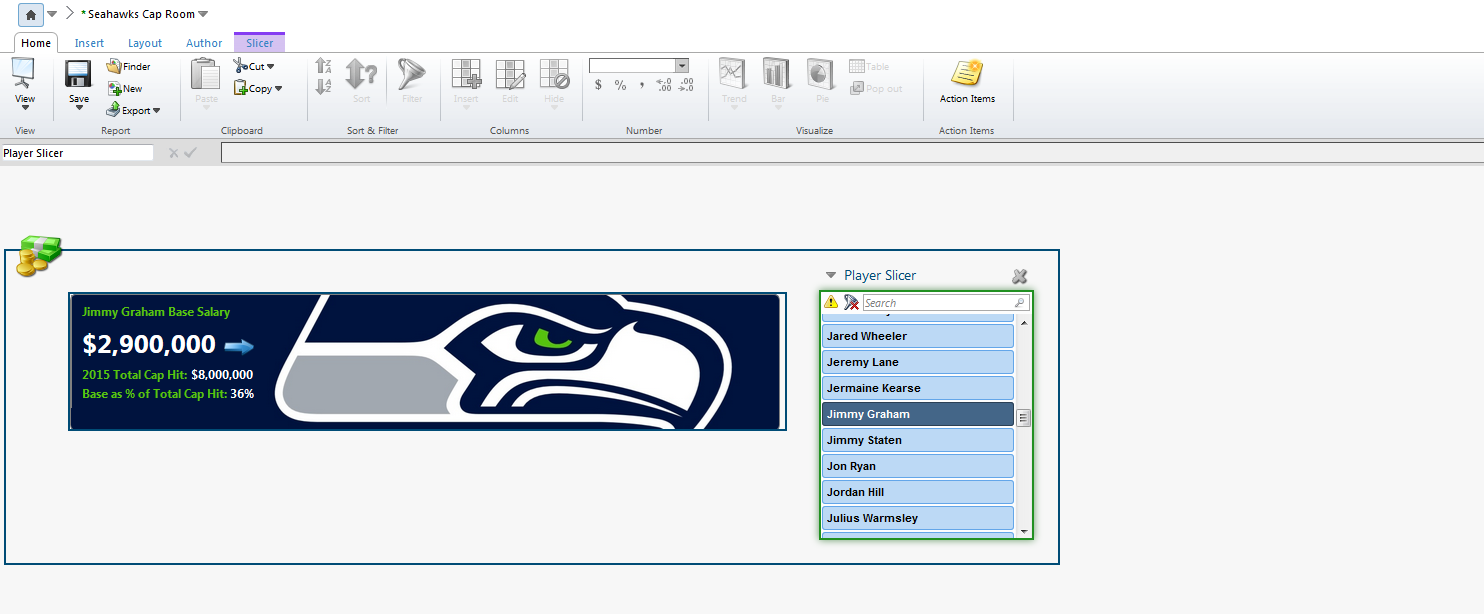

    However, you can also make your own customizations, which allow you to make the HTML/KPI appear however you desire!
    I've included the basic HTML/CSS that I used to create the base KPI frame below:
    <style type="text/css">
    li{
    list-style-type: none;
    font-size: 13px;  font-weight: bold;
    margin-left: 5px;
    .top{
    color: #004C76;
    .middle{
    font-size: 26px;
    .bottom{
    color: #808080;
    </style>
    <ul style="-moz-border-radius: 6px;-webkit-border-radius: 6px;-khtml-border-radius: 6px;border-radius: 6px;border: 1px solid gray;padding:0px;margin:0px;width:99%">
    <li><span class = "top">Cost</span></li>
    <li><span class = "middle"><%=numberformat(Cost,"$#,###")%></span></li>
    <li><span class = "bottom">YTD Cost: <%=numberformat(YearToDate(Cost),"$#,###")%></span></li>
    </ul>

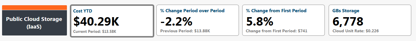

    Using the code you provided, I made a few modifications and wound up just changing the border width:
    And, it's nice to know I can use HTML and CSS to flexibly make other formatting changes if needed.
