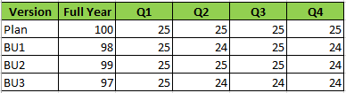

    Is there a way to build a metric that calculates a static quarter, i.e. always looks at Q1 no matter what month you're in, instead of looking at current month or month-1?  I have a feeling that there is, but I'm wondering if my specific use case that I need this for is complicating it for me.
    I have a number of different Budget outlooks that I load throughout the year, and I want to compare them all in one table view (see example below).  They are loaded into separate raw tables, and then consolidated into one transform table.  However, (and I think this might be the complicating factor), they are based on time in Apptio, so when you're looking at the transform in Jan FY2015, you are only seeing the January numbers for each version.  I can build a metric easily enough that shows me the current quarter's total, or any other quarter's total relative to the month that I am in.  But what I can't figure out how to do is build a metric that will always show me Q1's total regardless of the month I'm in in Apptio.  Any ideas?

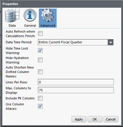

    1. Change data time period (report table properties).
    A report table can be locked to a different time period (or date range) other than the month selected near top center of the screen. Right-click a table > Properties > Advanced, to see:
    ...the Data Time Period field can be changed from Current Project Date to another option (current fiscal quarter, start of project time, start of quarter, etc.). But if you use this option to lock a report table to Entire Current Fiscal Quarter, it will only show Q1 if the user has selected one of the months within Q1--so it doesn't quite meet your described need.
