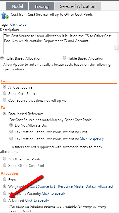

    One way to do this would be to use a Use Map Table.  Basically, you create a table that has the unique ID from the sending object, the unique ID from the receiving object and a weighting column.  Then, click on the Advanced allocation option (see below) and enter the following formula: =Use_Map_Table(table:weight_column[,source_column,target_column][,format)]
