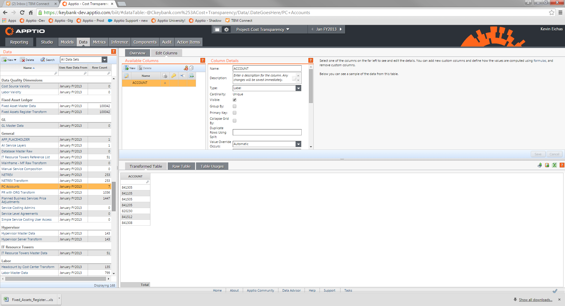

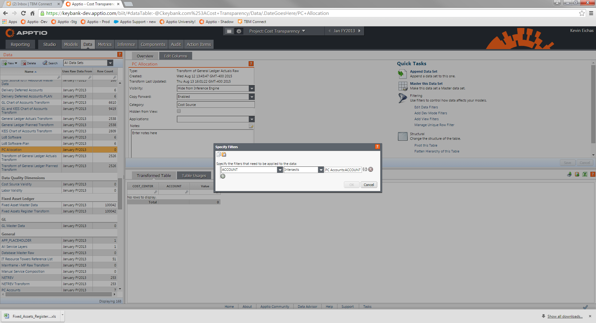

    So as you can see I have a table called PC Accounts, with values in an Account field type Label or String
    Then in my Data Set I am trying to create I have a filter where ACCOUNT (from raw data file) intersects with PC Accounts:ACCOUNT.  This filter should produce results but does not.

    Your configurations look correct in your screenshots.
    You may want to consider contacting Apptio's support team if you haven't yet about this issue.
