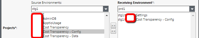

    We have created some reports that currently reside on stg sytem, is there a way to export this reports from one environment to another from STG to PRD for example. The specified item was not found.Apptio Community Home@Andrea C�rdenas

    You can move reports from one environment to another.  They would reside in the Cost Transparency - Config project.  You would just need to use either in In App Promotion and select the source that you would like to transfer (i.e. Stage) and then the destination (i.e. Prod).
    One side note to this is if you have added the report to a collection (i.e. IT Finance Collection, so when you click on that section, you see your report in the collection).  You would also need to push the settings as well.
    What I mean by the report collection is the following you would need to push the Settings as well.
    In-App Promotion:

    Please be aware that if you created the reports in stage and you try to push them to dev, it may not work.  Usually the config project is mastered in dev, which means that you would not be able to overwrite it.  Also, if you push the config up from dev to stage it will overwrite whatever is there.  You should check with your CSM or CSA to find out what enforcement settings are enabled so that you don't lose your work.
