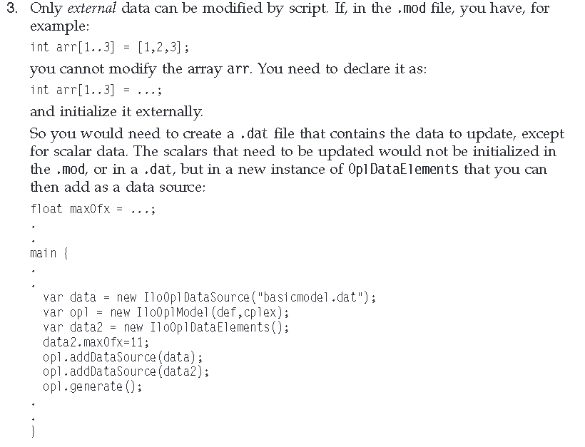

    Thank you, it worked I guess. Now IDE tells me that several string scalars in my model are not defined. So problem is in how I understand data modification in flow control. I'm following documentation for editing scalar variable in flow control and this simple example should be right by documentation:
    // .mod file
     int maxValue = ...;
     int minValue = ... ;
     dvar int x;
     maximize x;
     subject to{
             x <= maxValue;
     main{
            var src = new IloOplModelSource("TEST.mod");
            var def = new IloOplModelDefinition(src);
            var cplex = new IloCplex();
            var data = new IloOplDataSource("TEST.dat");
            var Model = new IloOplModel(def, cplex);
            var data2 = new IloOplDataElements();
            data2.maxValue = 30;
            Model.addDataSource(data);
            Model.addDataSource(data2);
            Model.generate();
    // .dat file
    minValue = 10;
    This simple example is not working. In documentation it is specified that in order to get scalar variable to change, one should not defined it neither in .mod file or .dat file, only external declaration via ellipsis syntax. Then an example is given, similar to one shown above.
    There must be something I'm missing. I would expect data-linkage in .generate() phase, but it seems that this is happening earlier, in .mod file syntax parsing phase?
    I'll be glad for any advice. Ondrej.

    To be specific, Tutorial: Flow Control part of the documentation, assuming string is 'scalar'
    So what is the difference, what I'm doing wrong?
