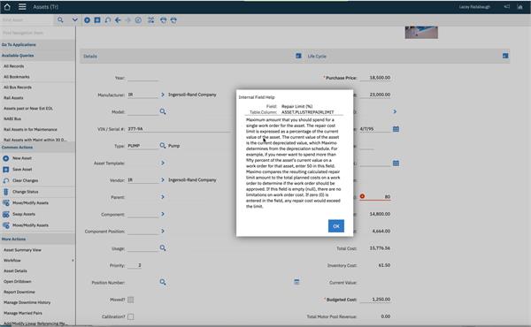

    1) You can set up a repair limit on an Asset.  Repair Limit is expressed as a percentage  of the asset's current value.  There is an option in Organizations that you can enable to receive a warning on the work order if your planned costs exceed the repair limit.
    https://www.ibm.com/support/knowledgecenter/en/SSLL9Z_7.6.2/com.ibm.trn.doc/plustorg/c_wo_option_trn.html
