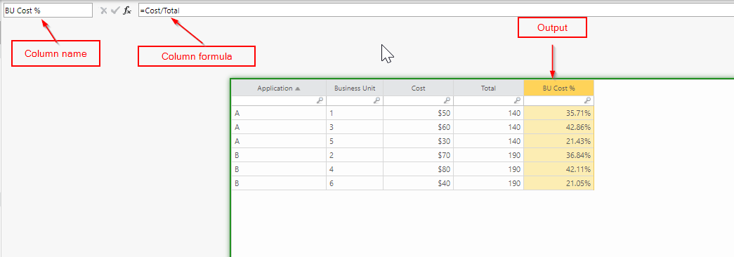

    Per @Jaitabh Jewel Sharma's comment, it would be good to see a screenshot of what you are looking for. In the meantime, I took a look at your ask and tried to mock something up. Let me know your thoughts.
    The above screenshot shows Application A and Application B, where they are both assigned to multiple Business Units. Cost column is the cost associated to the given Business Unit per Application. Total column is a sum of cost for each Application.
    Data that was uploaded in the original table: Application, Business Unit, Cost
    Total was calculated within the backing table using the formula:
    =SumIf(Application,Application,Cost)
    BU Cost % is = Table.Cost/TableTotal
    **Table to be replaced with the name of your table where the data is being pulled from

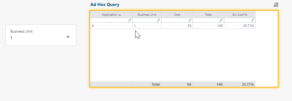

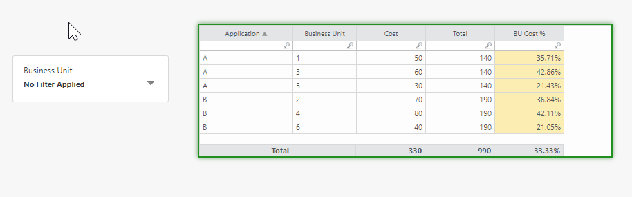

    Per your comments, you are filtering based on BU with the end goal that you will still see the % based on the total cost for that Application across all Business Units.
    I've filtered on a specific Business Unit. You will see that the BU Cost % is still based on the overall cost of the Application across all Business Units in which it's being allocated to.
    I've included all the columns for a visual example, but you can chose to show/hide as you see fit.

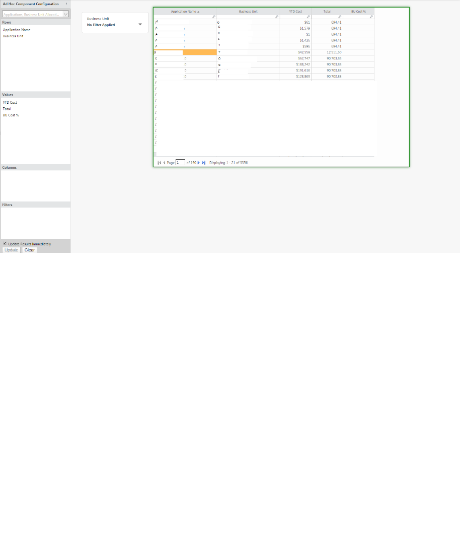

    So, I dont have Business Unit at the application level and I donth ave application at the business unit level. So my report, I am pulling application information from the App Object and the BU information from the BU object.
    Sorry my screenshot is ugly Im just trying to keep the confidentiality of the information as much as I can.
    BU % is empty because I tried a few formulas but cant get it to work .

    I feel sooo close!! Thank you this is such a huge help

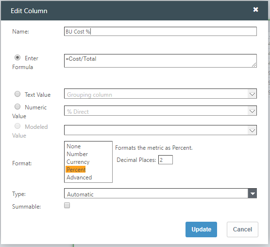

    Based on your screenshot, you should be able to modify the "BU Cost %" column to use the formula of:
    =YTD Cost/Total
    I used table.column for Cost as it was hard coded into the table for example purposes. Since you have "YTD Cost" and "Total" as net new columns, you should be able to use the formula above.
    To demonstrate I changed around my examples so that "Cost" and "Total" were net new columns to the table on the report. This mimics your current setup based on your data path.
    For the BU Cost %, the column should be configured as such:
    **For me I labeled the column as Cost. For you, it's YTD Cost. The following should still get you over that last hurdle.

    So, when I filter on the Business Unit, my Total cost changes vs yours stays the same. Maybe because im not using just 1 table?
    If I filter directly in the table it works (in the seach). If I filter using a slicer or in the report filter. It doesnt work, everything becomes 100%.
