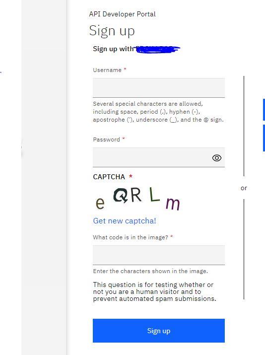

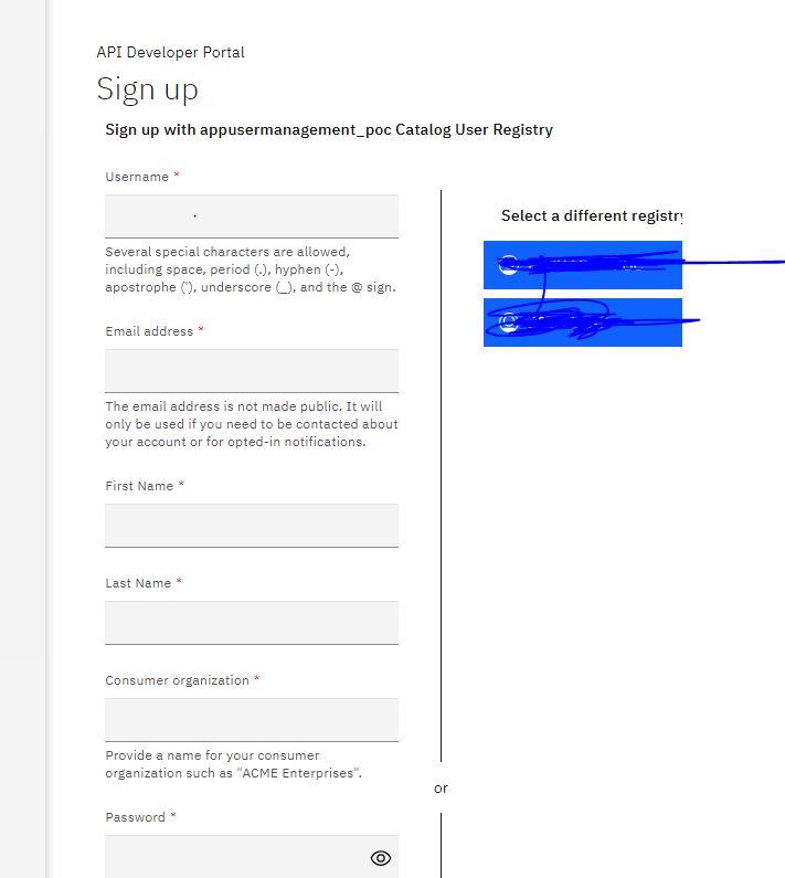

    see below: below image is shown when not using local registry. currently i don't see other fields like consumer org/email address etc ? which I would assume we need to add as custom field or am I missing something here.
    this is when you are not using local registry
    This is when using local registry
