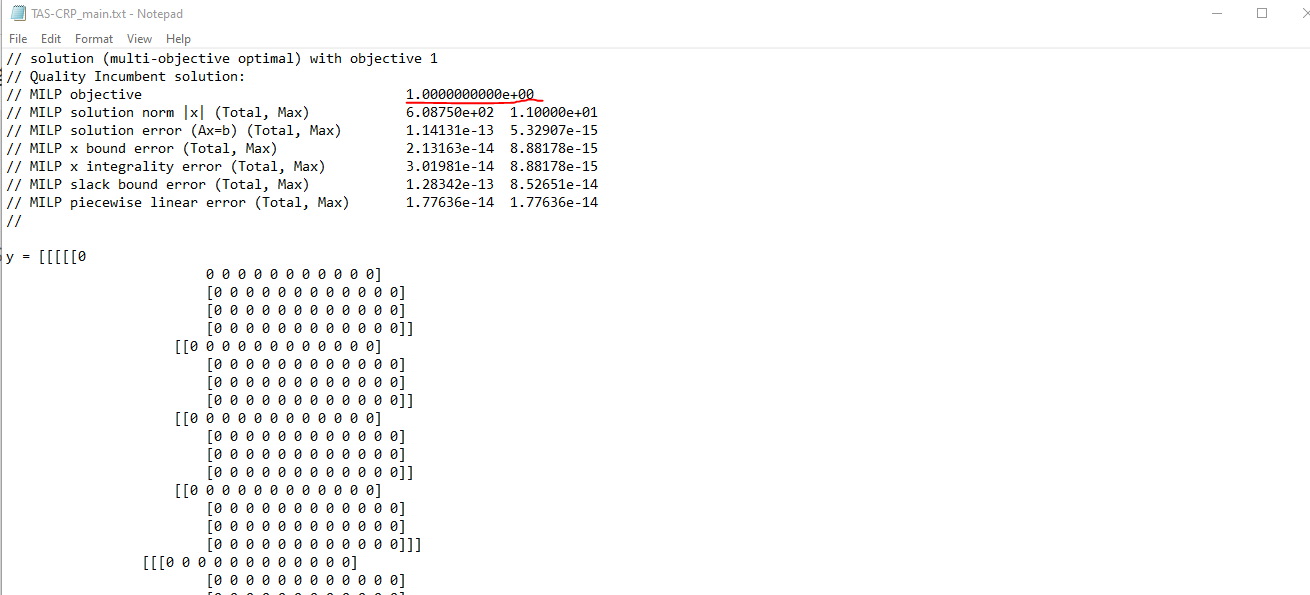

    I am solving a multi-objective problem with a lexicographic objective. I try to access the solution and print it out in an organized way to an excel file.
    The printed solution shows only the first objective function and the second is not printed to the output .txt file.
    here is my main script:

    var ofile = new IloOplOutputFile("TAS-CRP_main.txt");
    if (cplex.solve()){
    //ofile.writeln (" Obj ", cplex.getObjValue()," Time ",time );
    ofile.writeln (opl.printSolution());

    with writeln or SheetWrite you can write the 2nd KPI as can be seen at
    https://github.com/AlexFleischerParis/zooopl/blob/master/zoomultiobjective.mod
    that you can also rewrite with a main block:
