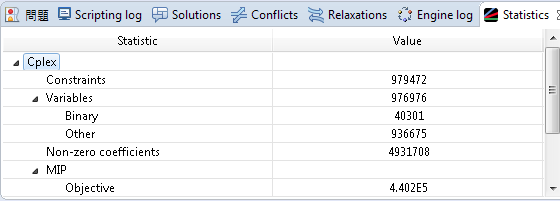

    Originally posted by: A6UM_Can_Nguyen
    Hi Alex,
    For (1), decision variables are below:
    For (2), I used the Emphasis parameter of 3.
    execute
    cplex.covers=3;
    Could you tell me how to get quick results?
    Thank you,
    Bests,
    Nguyen

  • 4.  Re: model works with long time
    Posted 07/23/18 04:59 AM
    Hi,
    if you want to set mip emphasis, try mipemphasis instead of covers.
    Do not hesitate to try to spend some time on improving your model.
    regards
