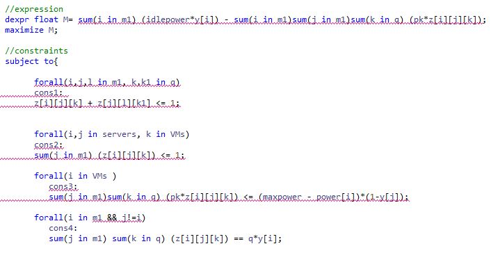

    I tried writing the algorithm, but still, I couldn't figure it out.Am getting errors.
    Please help me out.
    Algorithm is:
    Please find attached the CPLEX files.
    Thanks in advance.
    Please solve this issue.
    Regards,
    Srihitha.

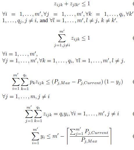

    I founded out the error. It occurs at z[i][j][k].
    Actually, z[i][j][k] is the bivalent variable expressing migration of VMk from server i to server j.
    But, declaring as shown above (z[i][j][k]) is incorrect. Please provide me an answer to proceed with.
    Thanks in advance,
    Srihitha.

    if you rewrite cons1 and cons2 into
    cons1:forall(i,j,l in 1..m1, k in 1..q[i],k1 in 1..q[j])
           //cons1:
              z[i][j][k] + z[j][l][k1] <= 1;
           cons2:forall(i,j in 1..m1, k in 1..q[i])
              //cons2:
              sum(j in 1..m1) (z[i][j][k]) <= 1;
    your model will work better.
    See
    https://www.ibm.com/support/knowledgecenter/en/SSSA5P_12.6.1/ilog.odms.ide.help/OPL_Studio/opllangref/topics/opl_langref_constraints_labels_limit.html
    for limits with labeling constraints
    regards

    cons4:
              forall(i in 1..m1)
              sum(j in 1..m1) sum(k in 1..q[i]) (z[i][j][k]) == q[i]*y[i];
    If you realize that y is [ 0 0 0 1] and q is [2 2 1 0]
    you ll understand that for all i in 1..m1
    needs to be 0 which explains why all z are 0
    regards

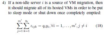

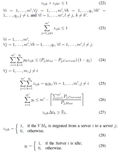

    Please have a look at eq-25 which is cons4 in our code. Neglecting eq-27, the rest (22-26) are our 5 constraints.
    Also, what do those warnings mean?
    And, how should we include i !=j (i not equal to j) in some of the constraints?

    let me  comment the first one:
    Instead of
    cons1:
              forall(i,j,l in 1..m1) forall(k,k1 in 1..q[i])
    you could try
    cons1:
              forall(i,j,l in 1..m1:i!=j && l!=j) forall(k,k1 in 1..q[i]:k!=k1)
    The warning meant that the decision variable was not used in any constraint.
    Are you a student ?
    regards

    For this algorithm, the inputs are x ij  matrix and ematrix.
    Decision variables are z ijk and yj , in which, the 'y' values depend on 'e' values like if e[j] = 0(server j is not being used i.e idle server), then y[j]=1(idle server)  and vice-versa.
    But, in this algorithm, if we are declaring y as a decision variable and giving this condition on "e[j]", then we are not getting the values of 'y' exactly as opposite as 'e.' We are getting some random stuff for 'y' by which q*y may not become zero.
    Unless, if we directly feed in the exact opposite values of 'e' as the matrix 'y', then obviously q*y values become zero and we are getting z values as zeroes.
    So could you suggest us something that works..

    This is the explanation for cons4.
    y=0,if server is non-idle
    y=1, if idle
    Thanks,
    Srihitha.
