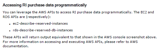

    Additionally, page 13 is not very clear in explaining how to access Reserved Instance data from AWS.  Is there supposed to be another API report that I can set up to get this?  There seems to be only 5 options - the 4 main reports that I already have (Billing Detail, Billing Detail with Tags, Cost Allocation, and Monthly Summary), and then an Advanced option.  My assumption is that I would have to use the Advanced option, but that's not really mentioned in the instructions.  All that's there is this:

    In terms of your question around AWS Reserved Instance purchases, those are not currently accessible via the Datalink AWS Connector - they need to be brought into Apptio either manually or via the Amazon API.  We will address that topic in more detail within a separate Community thread (and will point this thread to the new topic).
