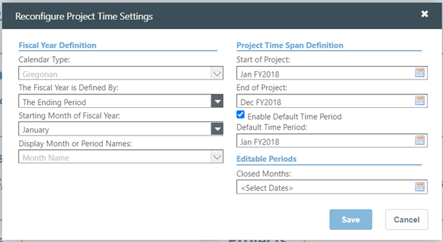

    Have you ever used the Editable Periods portion of your Project Time settings?
    The Editable Periods dropdown, lower right corner,  allows you to choose a specific time span of your project and lock those months so no further changes can be made.  This is a great technique for saving any historical data after you've completed reconciling those months.  For instance, if you have a three-year project (2020-2022) and you've just finished reconciling the data for 2020 you may want to lock that data so no other changes can be made to it.  If this isn't something you've considered before I recommend looking at these settings.  There is also a great write-up of all the functions in the Project Time Settings on our Apptio Community pages.
