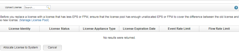

    The main problem is that we cannot allocate the new license to our system. On one system, there is this "null" host as the only possible host available for allocating the license. On the other system (Testing purposes) there is none. We can upload the license, but we cannot allocate it. The list below is empty: "No results were returned"

    So the response from q1pd confirms that the license is valid, but there is something going on in the tables or possibly a deploy issue that is preventing this license from being allocated. If this is your core system, I'd open a sev1 case on this to get someone from our team to take a look at the tables and get things cleaned up as you have no EPS allocations if you cannot assign the license. The logs will give the support rep an idea of what is going on, but my guess is that there is an issue where something didn't deploy properly or a table needs to be cleaned up manually.
    Get a case open, attach your logs and someone can review this in detail.
