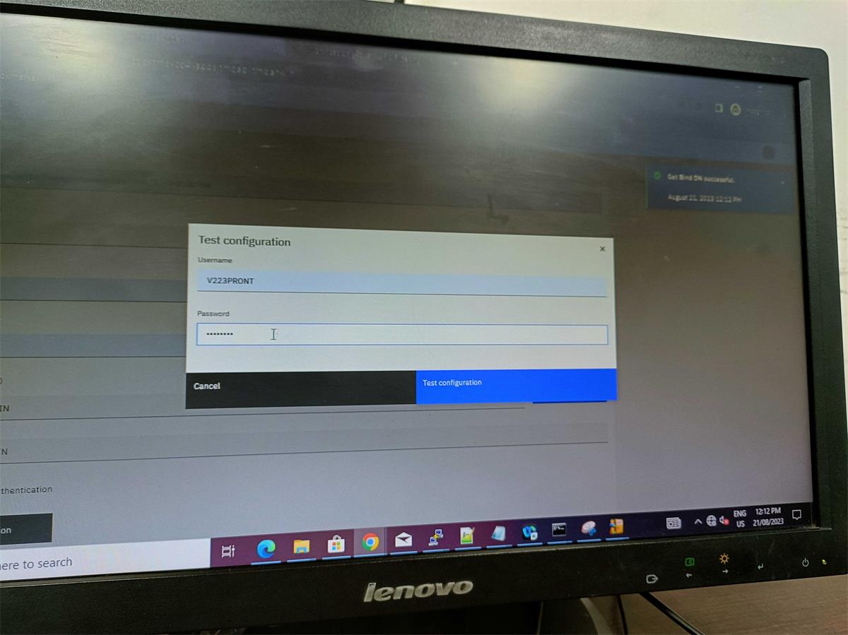

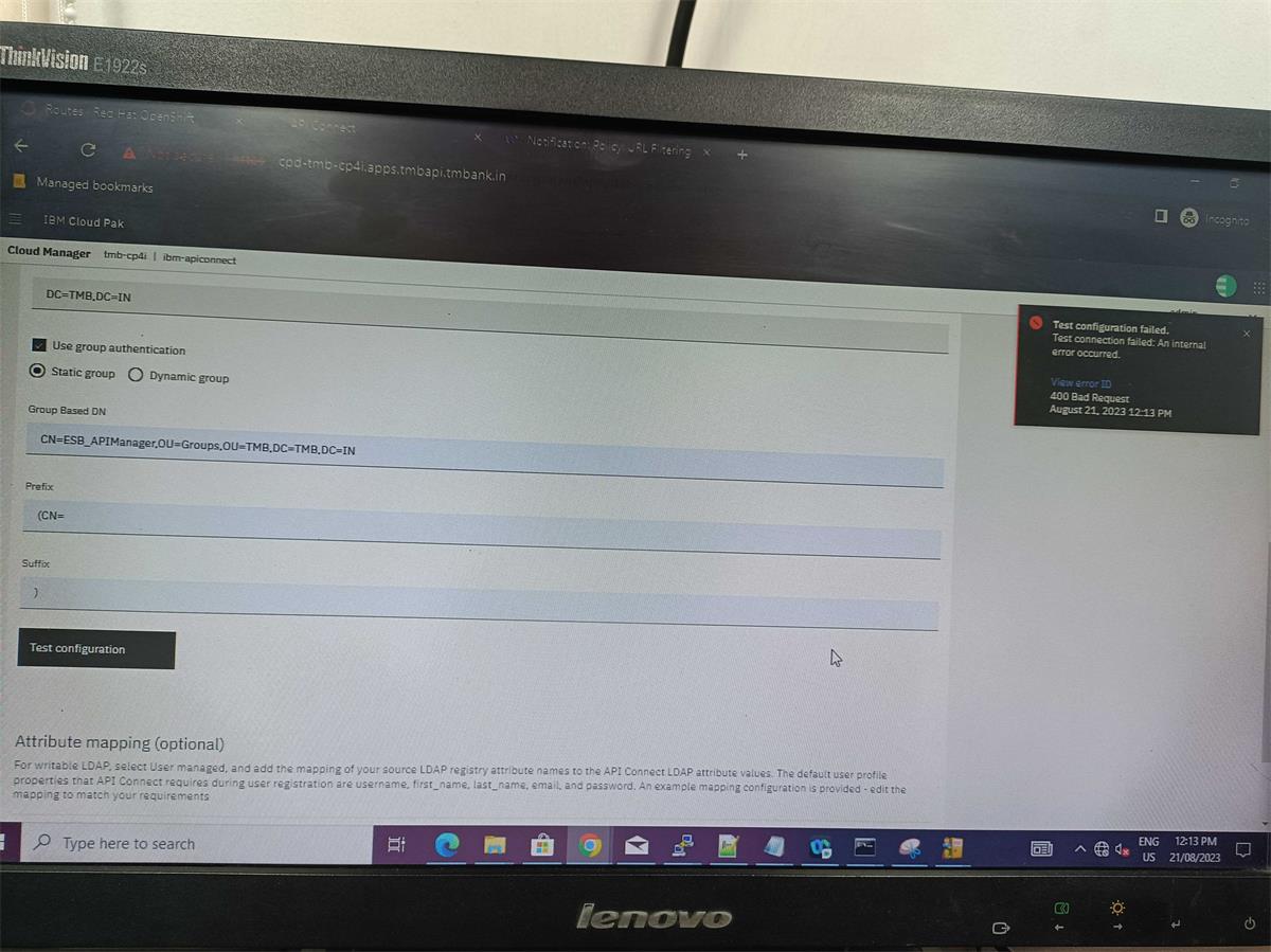

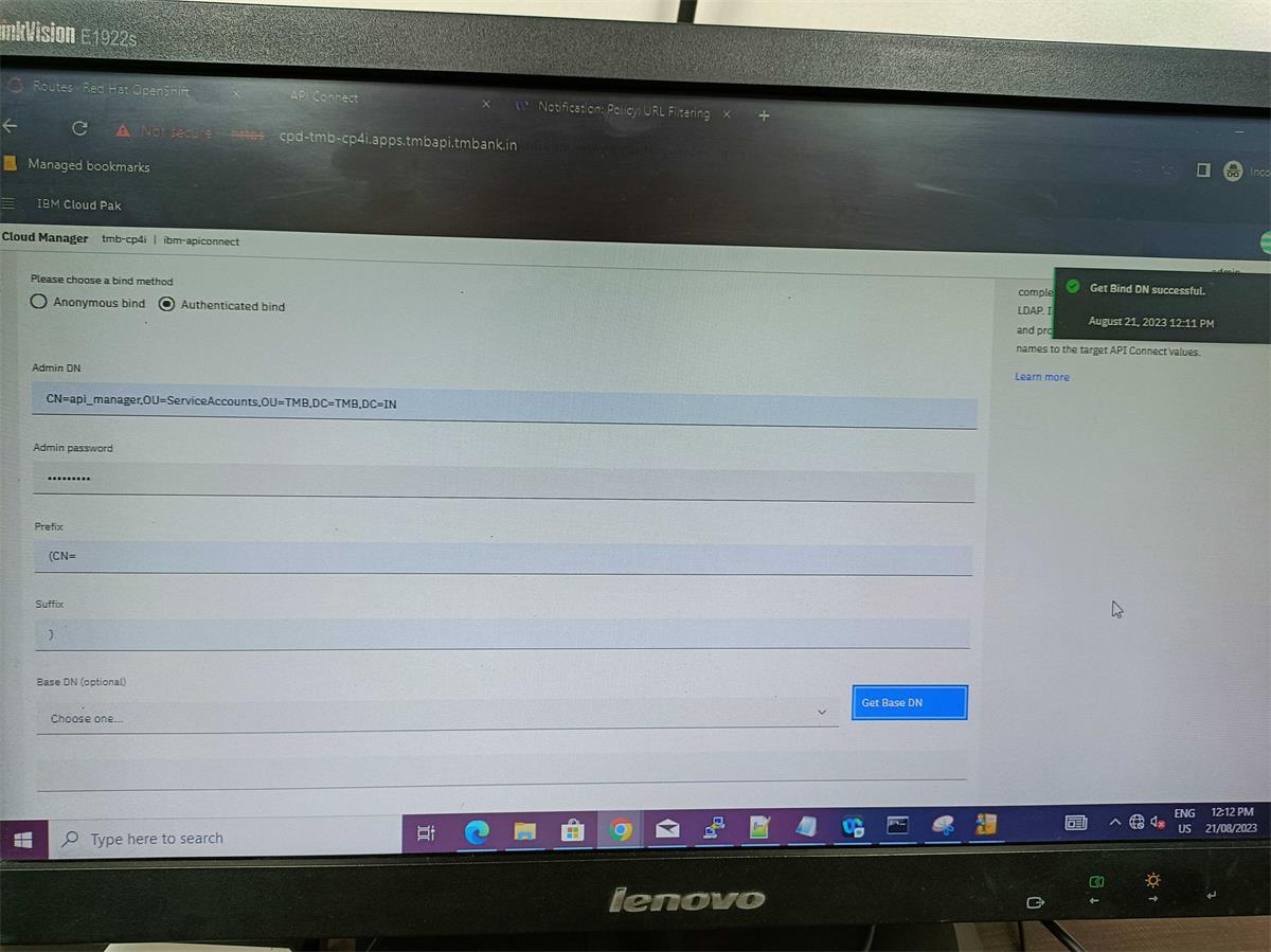

    Hi All,
    We are configured LDAP in cloud-admin. Our LDAP Team created service group in that they created one group in that they added some users.
    1.Given title LDAP IP and PORT.
    2.Authentication method Search DN, used Authentication bind
    3.Given all required things and we are tried test configuration i given user and password that user is in group it showed -->Test Configuration Successful.
    we are enabled User group authentication--> static group given group DN prefix and suffix
    when hitting test configuration i given same user and password it showing -->test Configuration failed(An internal error failed.
    I am uploading screenshots about configuration. Kindly check and provide a solution ASAP.

  • 3.  RE: LDAP issue while Integration with API Manager
    Posted 08/22/23 01:49 PM
    Looks like the group prefix and suffix might be wrong.
    It should be that of the group field in the user entry.
    Eg:
    group_authentication_method: 'static',
    static_group_dn: 'CN=Users,DC=apim,DC=ibm,DC=com',
    static_group_filter_prefix: '(&(member=',
    static_group_filter_suffix: ')(cn=apimsvt))',
    Nisha Narayanan
