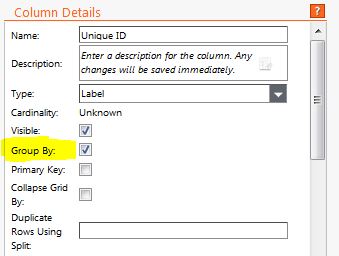

    In the data set, have you tried using the Group By: selection (image below) on the Employee ID column?  Apptio will group all resource entries that have a common Employee ID and sum all numeric Types (hours & amount billed).  If the same resource does have different Label types for other columns, Apptio will report as {Various}.  If you need to differentiate entries on more than just Employee ID, create a new column to group on and concatenate the necessary columns.
    After grouping on Employee ID, a new column identified as .Count will be created that you can then reference to normalize the head count from two or more for multiple entries down to one.
    Capture.JPG]

    Thank you. I thought of this but wondered as it will create {Various} in Unique ID.  I went ahead and applied Group By on Labor ID, not sure if {Various} in Unique ID broke something.
    Thanks
