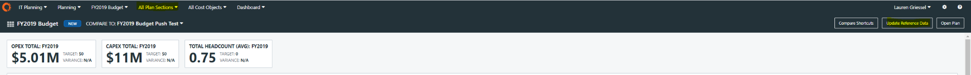

    Hello there, kindly help. I have updated my reference data in IT Planning but the changes are not reflecting in the IT Planning dashboard.

    Hi,
    You need to always complete these 3 steps when updating reference data:
    1. Upload data
    2. Publish the data
    3. Update the reference data in the specific plan you wish to see the changes in

    Hi Lauren,
    I had already done step one and step two as you mentioned, but I cant seem to find stem 3. Find attached screenshot of my problem. I have changed the names under all departments under reference data and published the data but cannot find the option where i need to update the reference data under planning.

    Hi,
    The update reference data button in a plan is in the top right hand corner of the screen and you have to be at all plan sections to see it:

      |   view attached
    Hi Lauren, i do not have the all plan section. Checked everywhere.See attached screenshot.

    Then at the all departments level you should see it if you do not have projects enabled.

    Thank you. Had to create a new forecast plan.
