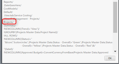

    Recently we made a model change - integrated "NSSR Object" to "Projects". Model allocation looks OK, but we are seeing an issue with "IT Management - Project Details" which is Apptio Out of the Box Report. Please see the attachment for further details.
    Error Description -  Please provide a row or column to cross reference 'NSSR to Projects Stage' and 'Projects'.

    Based on looking at the report, the report is leveraging the Projects Object.  When you were adding the additional object it sounds like you were adding it before the projects object.  Do you still have costs going to the project's object?  Also, is there a relationship between NSSR and Projects object?  If not, I believe that you'd have to leverage the join and combine the tables on a common attribute.
    Also, has there been any customization to the report where you added a column from the NSSR object?

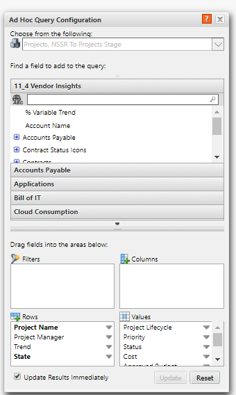

    I want to extend this thread since we noticed somewhat a different behavior with "Project Details" report. As described in my previous thread the exact model change is I just added a NSSR to Project Stage object and moved the cost to the existing Projects objectOn the "Project Details" report we have not pulled any column from "NSSR Stage" object, but even then on the adhoc perspective we see both "Projects and NSSR to Project Stage" are joined. (Please see the attachment)
    Because of this default "drillTo" behavior (which we didn't intent) the Project Details report shows only the projects match between NSSR Stage and Project object. Ideally it should display all the projects available at "Projects object".  I'm not sure If I have done something in the model which would have caused this behavior of two tables joining the adhoc table.

    The drill will be forced if you are filtering/showing a column from the NSSR to Projects Stage Object.
  • 10.  Re: IT management --> Project Details Report doesn't work
    Posted 10/17/17 05:02 PM
    Hi Babu,
    In your snapshot, pull Project Name out of the rows section in the Ad-Hoc Query Configuration Box. You'll see the NSSR to Projects Stage object fall out of the top of the box and the table will show an error (only because there's no grouping rows, we'll fix that with the next step).
    Then go into the Data perspective and grab Project Name from the Projects Master Data and put it into Rows where it was before.
    The table will no longer be a drill at this point (confirm by seeing only Projects listed in the top section of the ad hoc query box).

    Thanks a lot @Taryn Kane, it worked. I understood the mistake was "Project Name" was not pulled from the right perspective.
