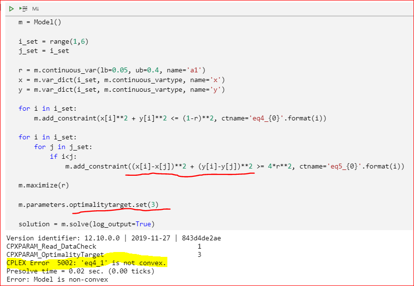

    I want to solve a small nonconvex quadratic problem (using the free version of CPLEX in Python environment) and I am not sure where the issue comes from. The nonconvex term is one of my constraints. I get CPLEX Error 5002 even though I set the optimality target parameter to 3. A screenshot of my code is attached.
    Thank you for your support in advance,
    Hossein

    According to the documentation, target setting 3 does not apply to quadratically constrained problems. As far as I know, CPLEX can only deal with nonconvex quadratic expressions in the objective function of a linearly constrained problem.

    That is a bummer! Thanks for your quick and helpful comment, Paul. Really appreciate it!
