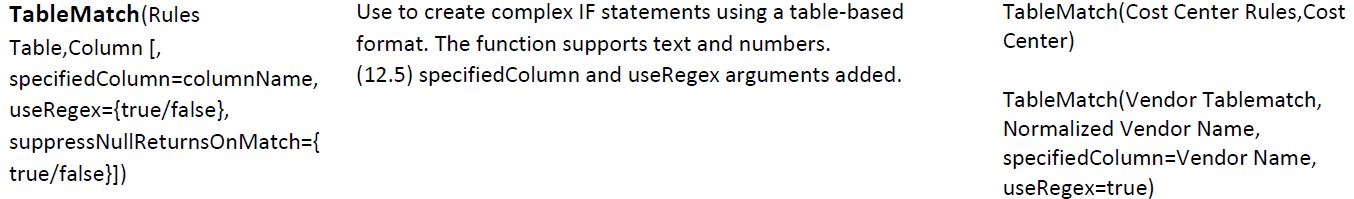

    Have you tried Tablematch?

    I was going to suggest the same thing that @Tony Wong suggested above. A Tablematch may suit your use case, as you can have a key column to match against, and you could then return all of the items in the table that match your key.
    One thing to note is that with a Tablematch, the table used for the formula must have column headers/names that match the column you're searching from in order for it to be found. So if you've called it "Key" in the originating table, then you'll want to call the column you're searching against in the Tablematch table "Key" as well.
    Here is a link to the document on Tablematch: https://tbmcouncil.jiveon.com/docs/DOC-5073
