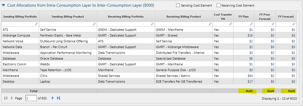

    We have a custom formula drillable column and want to enable grand total row, but the grand total row shows NaN or 0.
    Format used here is advanced =EvalWiki($_)
    Somehow I noticed that this column is considered as text and not numeric and hence summable or total row feature shows NULL values.
    Does anyone know how to get grand total to show total?

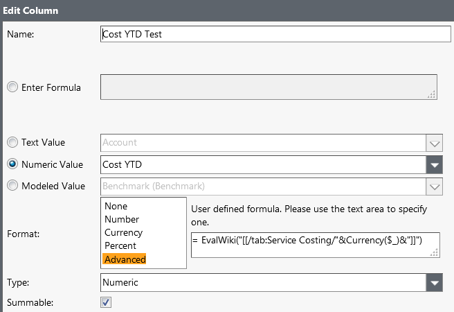

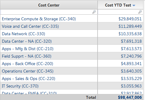

    Here's a working example - maybe compare your settings to the ones below?

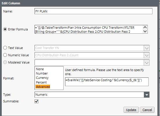

    You'll want to modify the Format/Advanced formula to include all of the EvalWiki-related parameters, and then remove them from the top formula.
    In order to correctly display totals in the bottom table row, Apptio needs this top formula ("Enter formula" section) to just contain the numerical equation with no formatting or extra characters. All of the formatting should instead be placed in the Format/Advanced section.

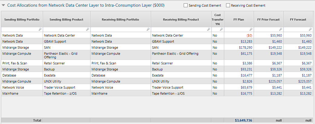

    Does this look correct? null value (have all 0s in those 2 columns)

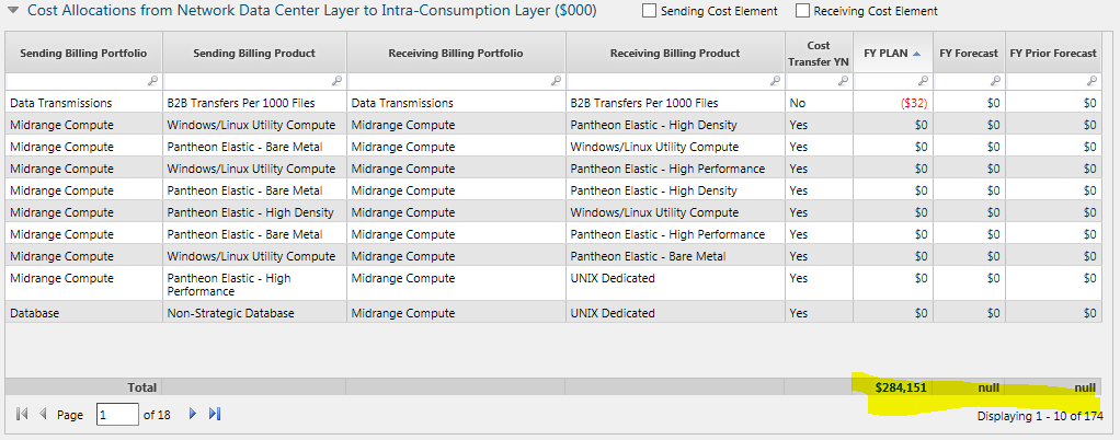

    If FY PLAN column and its total sum row are working, then a similar approach should work for FY Forecast and FY Prior Forecast columns and total sum rows as well.
    Just for testing purposes, you could try temporarily forcing at least one non-zero value into the FY Forecast column to see if the null converts into a proper value. If so, then it seems okay to let the total row say null for the time being, because you'll eventually have non-zero values in the two rightmost columns.
