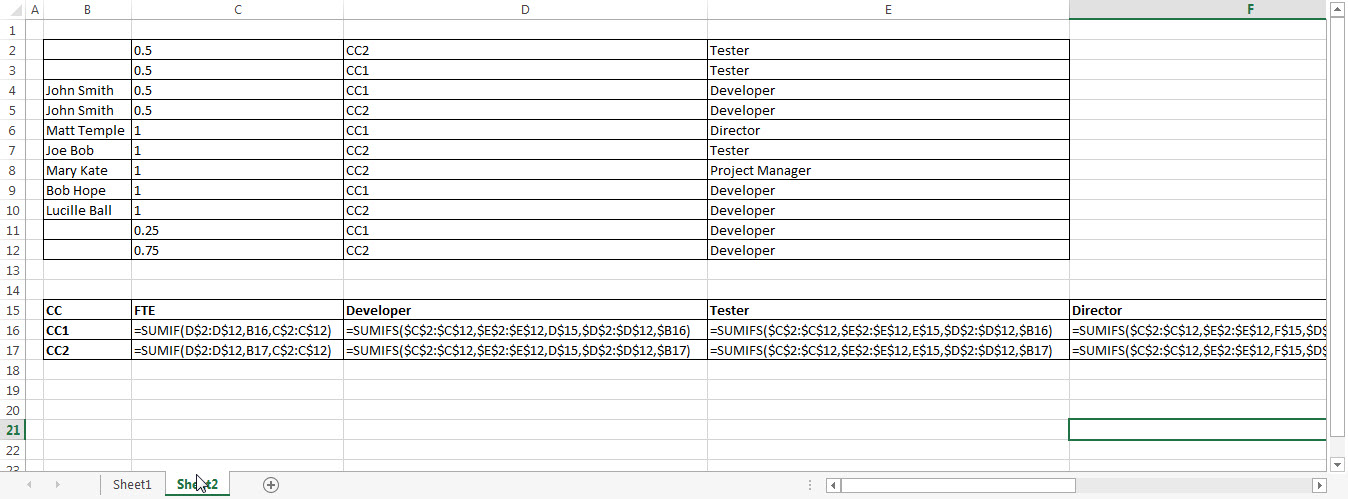

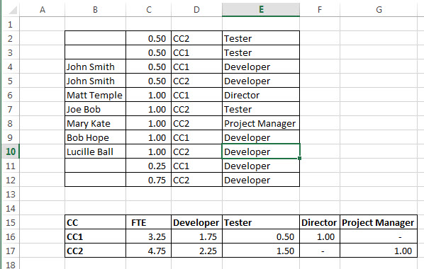

  • 4.  Re: Headcount Formula
    Posted Tue April 18, 2017 04:51 PM
    Hi @Molly Meinert!
    I think these screenshots (quickly put together in Excel) relate to what you're getting at. If you concur, I think it's easy enough to translate the logic represented in the second screenshot into Apptio CT. If not, let me know and I'll come up with something.
    Extending on this, I have also created an approach to track FTE values for actual heads per month taking into account start and finish dates of each person on the roster and relative to the number of working days in each fiscal period. If interested, I'm happy to share my approach.
