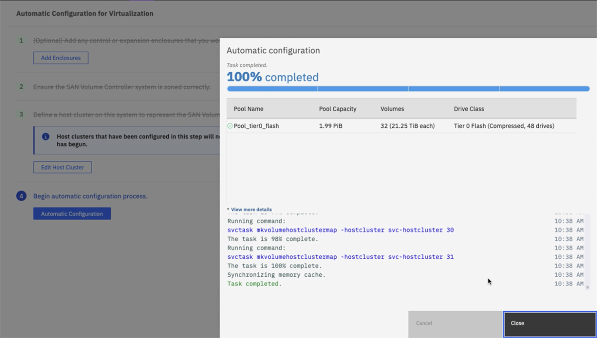

    Hola @Johan van Arendonk,
    I'd say you can take a look at the redbook "IBM FlashSystem Best Practices and Performance Guidelines", section "3.3.2 Guidelines for creating optimal backend configuration". For instance, I read "For all-flash backend arrays, IBM recommends creating 32 logical volumes from the array capacity", I can confirm such rules are the same if using the Automatic Configuration Wizard. Here an old picture from a very quick test in an FS9500 with 48 FCM I tried some years ago:
    Luis Lopez

    Nezih, Luis, thanks for the reply.
    The point is that the automatic configuration has already created 32 volumes for the 12 FCMs, plus another 5 volumes for RESERVED_SPACE* (based on a pre-specified compression ratio).
    If I now expand the array by 4 FCMs, how does that compare to the existing 37 (32 + 5) volumes? Then the original calculation is no longer correct, right? But perhaps I shouldn't be too fixated on those 32 (best practice).
