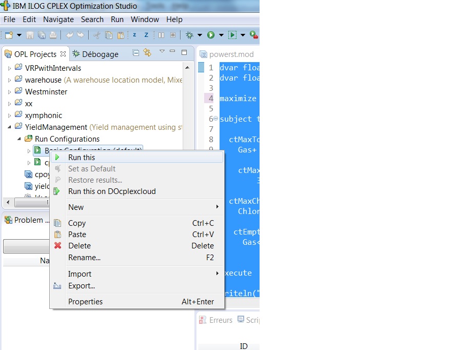

    in order to be sure, let me ask a question : do you click on the green arrow ?
    regards

    do you confirm you right click ?
    regards
    #DecisionOptimization
