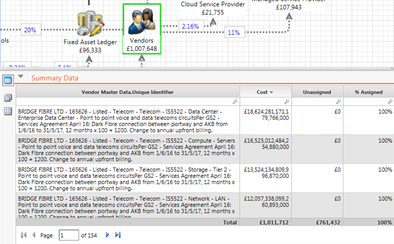

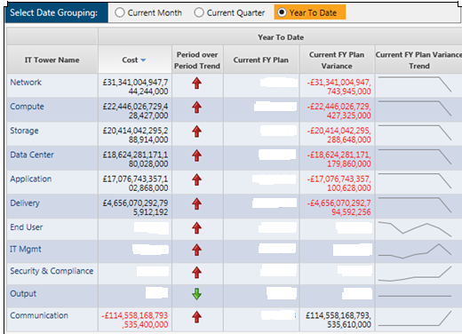

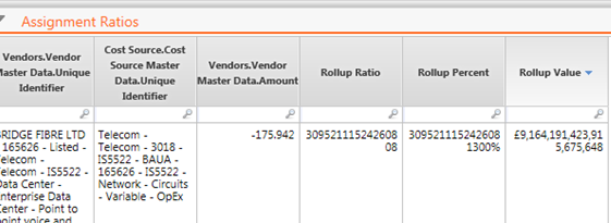

    After working on making our costs to Towers (via Vendors) more accurate an issue has arisen mid year:
    Our totals are correct but the Tower breakdown is grossly overstated.

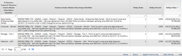

    The rollup figures on the model are also affected:
    I've tried to recreate the figures but am stuck as to where they are coming from - any help would be greatly received

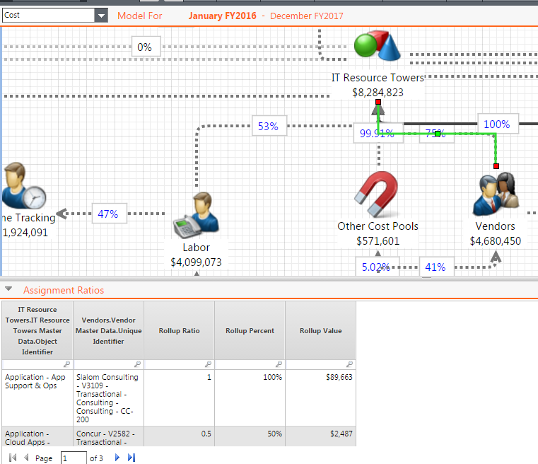

    Julie - Can you please take a screenshot of the Allocation logic from Vendors to ITRT?  I think this would be a good place to start.

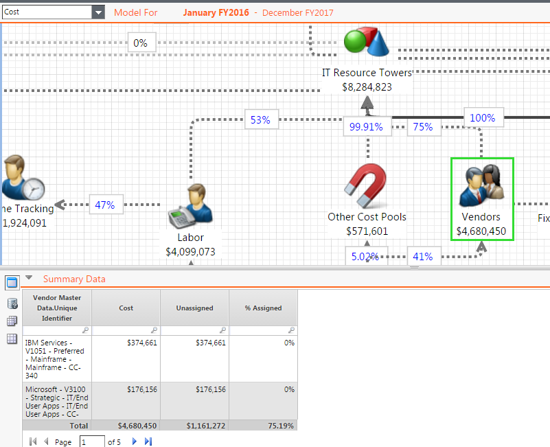

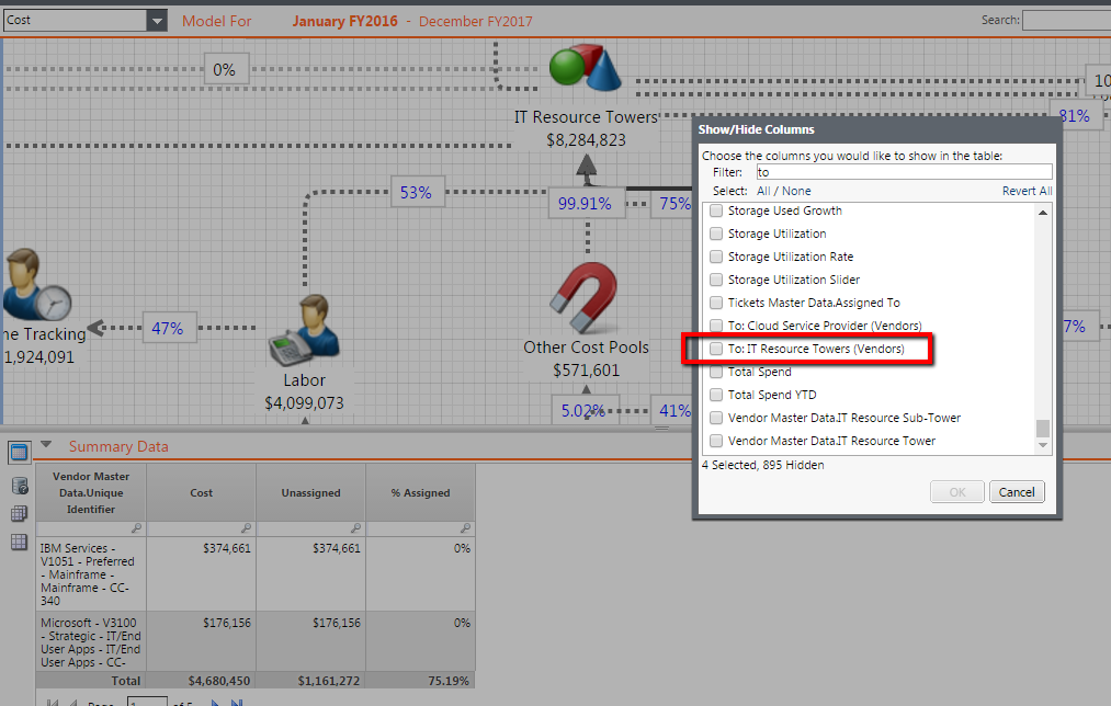

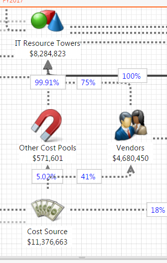

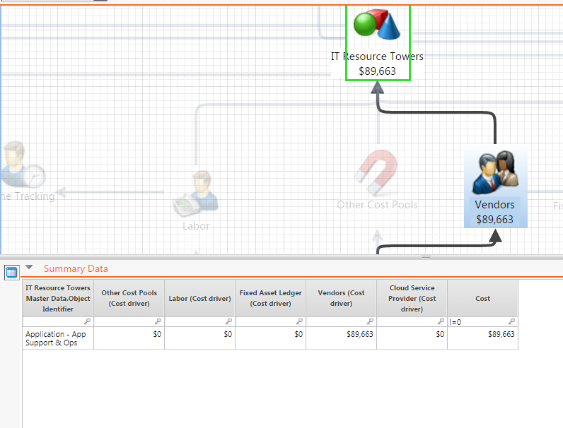

    Julie - Can you see if you can grab shots like the following:

    Yeah it looks like you are going to have to concentrate around the Cost Source to Vendors allocation and the weighting you are using for it.

    Can't quite figure out why the Amount on the Vendors Master Data is skewing the cost. I've raised a ticket with support so hopefully I'll have a helpful response to reply with

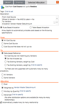

    What is the logic you are using to get from Cost Source to Vendors?
  • 10.  Re: Exaggerated Spend to Towers
    Posted 02/14/17 11:47 AM
    From: All Cost Source
    To: Data-based Reference - Do Not Allocate Up
    Allocation: Vendor Master Data.Amount - many to many ticked

    Can you send a few screenshots of the allocation?  This one is interesting hahaha.

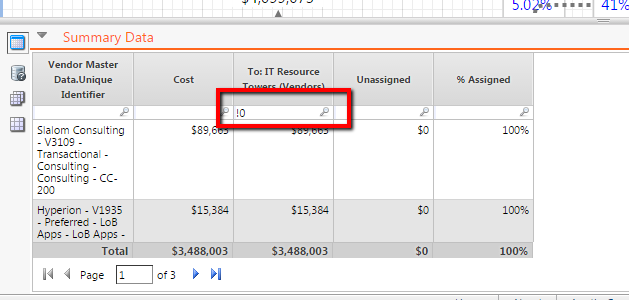

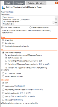

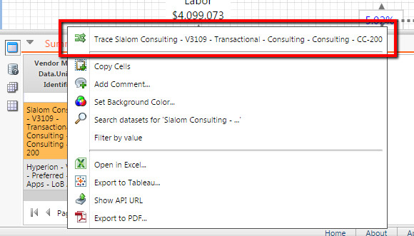

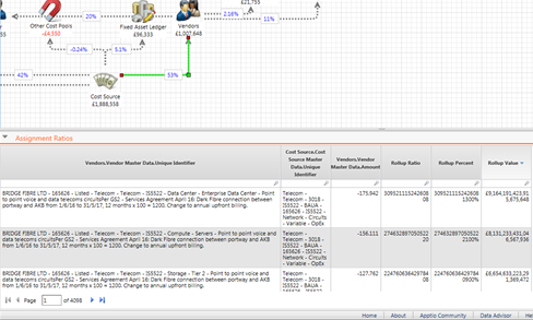

    A few screen shots:
    The annoying part is that when I trace a line through the model from Cost Source up the correct value appears - something strange happening between Cost Source and Vendors, may have to rethink the weighting option!

    I would also look at the granularity of your vendors object and the key.  Sometimes that Many to Many selection could cause an issue.  See if you can get your key to move a little cleaner and that might take care of your problem.
    I would also make sure you include a lot of these items in your ticket to make sure they understand exactly what you are looking at.
  • 14.  Re: Exaggerated Spend to Towers
    Posted 02/14/17 11:15 AM
    The Cost Source to Vendors is the same apart from being weighted by the Amount at Vendors
  • 15.  Re: Exaggerated Spend to Towers
    Posted 02/14/17 11:21 AM
    Think I've found the root of the issue but not the cause as such - the weighted by column of Amount at Cost Source seems to be the culprit - I'll work through to see why it's happening

    I have seen this before with Cost Source to Vendors and then to IT Resource Towers.  I would suggest looking at the keys as Doug suggested.  When I saw this it turned out to be that the CS_Vendor Key contained a various and when the amount (weighting) was applied it created a huge negative number.  The weird thing is that it happened only in Stage, never showed up in Development. I ended up having to increase the granularity of the Cost Source to get rid of the various.   Doug has got you pointed in the right direction with checking all the stuff you checking.

    There is currently no {Various} on the keys but support have stated that issue seems to be around the weighting as some of the figures (rounded up) are 0 and these causes the figures to be distorted.
