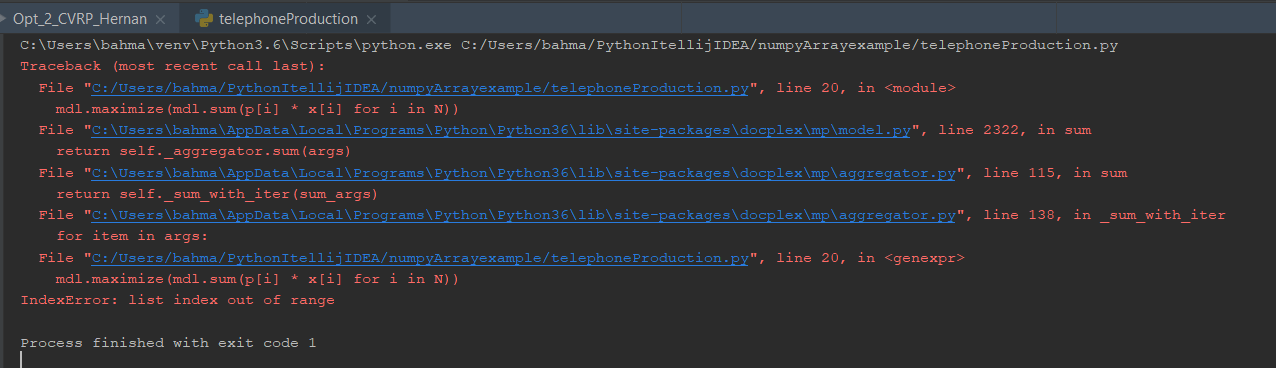

    I appreciate your prompt reply. However, it doesn't seem to be due to parenthesis since I got these errors
    Regards,
    Bahman

    The problem seems unrelated to docplex but looks a basic Python problem. Consider this
    n = 2
    N = [1, n]
    p = [12, 20]
    x = mdl.continuous_var_dict(N, name='x')
    mdl.maximize(mdl.sum(p[i] * x[i] for i in N))
    The lists p and x both have size 2, that is, valid indices are 0 and 1. Now in your code you reference p[i] and x[i] and you have 'for i in N'. Since i ranges through N it will be 1 and 2. The first value is a valid index, the second is not. I guess what you want is something like 'for i in range(len(N))'.

    Originally posted by: BahmanBornay
    Hey Daniel,
    I found the issue: the range(len(N)) does not work, since p is indexed from 0 to 1, but x is indexed from 1 to 2. Thus: the following code worked:
    mdl.maximize(mdl.sum(p[i] * x[i+1] for i in range(len(N))))

    Ah, yes, you are right. x is a dictionary rather than a list and the keys are the values from N.
    A more robust way to write your objective would be this
    mdl.maximize(mdl.sum(p[i] * x[n] for i, n in enumerate(N))
    This does not depend on a particular relationship (like 'i' and 'i+1') between the values in N and their indices. It only assumes that the k-th variable is given by x[N[k]].
