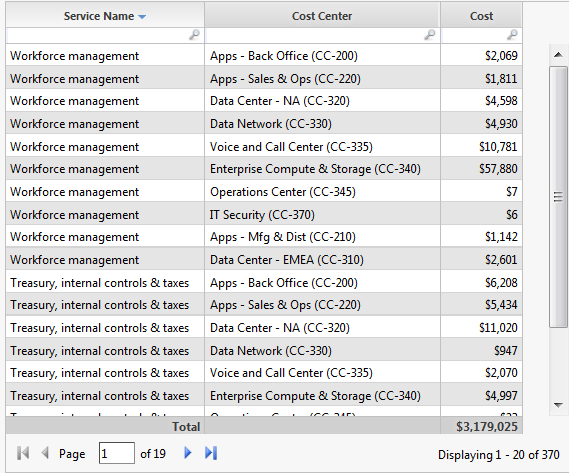

    For example (dummy data):
    The service named Workforce management has $85,825 cost at the Business Services object level, and the breakdown per cost center is shown in the table above (one row per cost center).

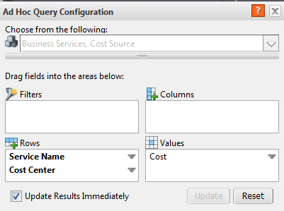

    Here's its configuration window for reference:
    ...notice the grayed-out context near the top, indicating this table is locked to both model objects at once.
    I found Service Name published in the Services perspective, and I found Cost Center in the Service Costing perspective.
    Your perspectives and columns may have different names.
