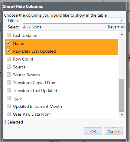

    That being said, I've helped other customers add this to a report to show the timestamp the raw data was last updated. To do this you could.
    1. Insert Freshness Table
    2. Show the "Raw Data Last Updated" column:
    3. Filter this table to just the dataset(s) you want to show on the report.
    I understand this won't give you a column in a table to manipulate, but it may give you an idea of something different to try. I am also unaware if you could create a lookup against the freshness table in a transform to pull this data in to your transform.

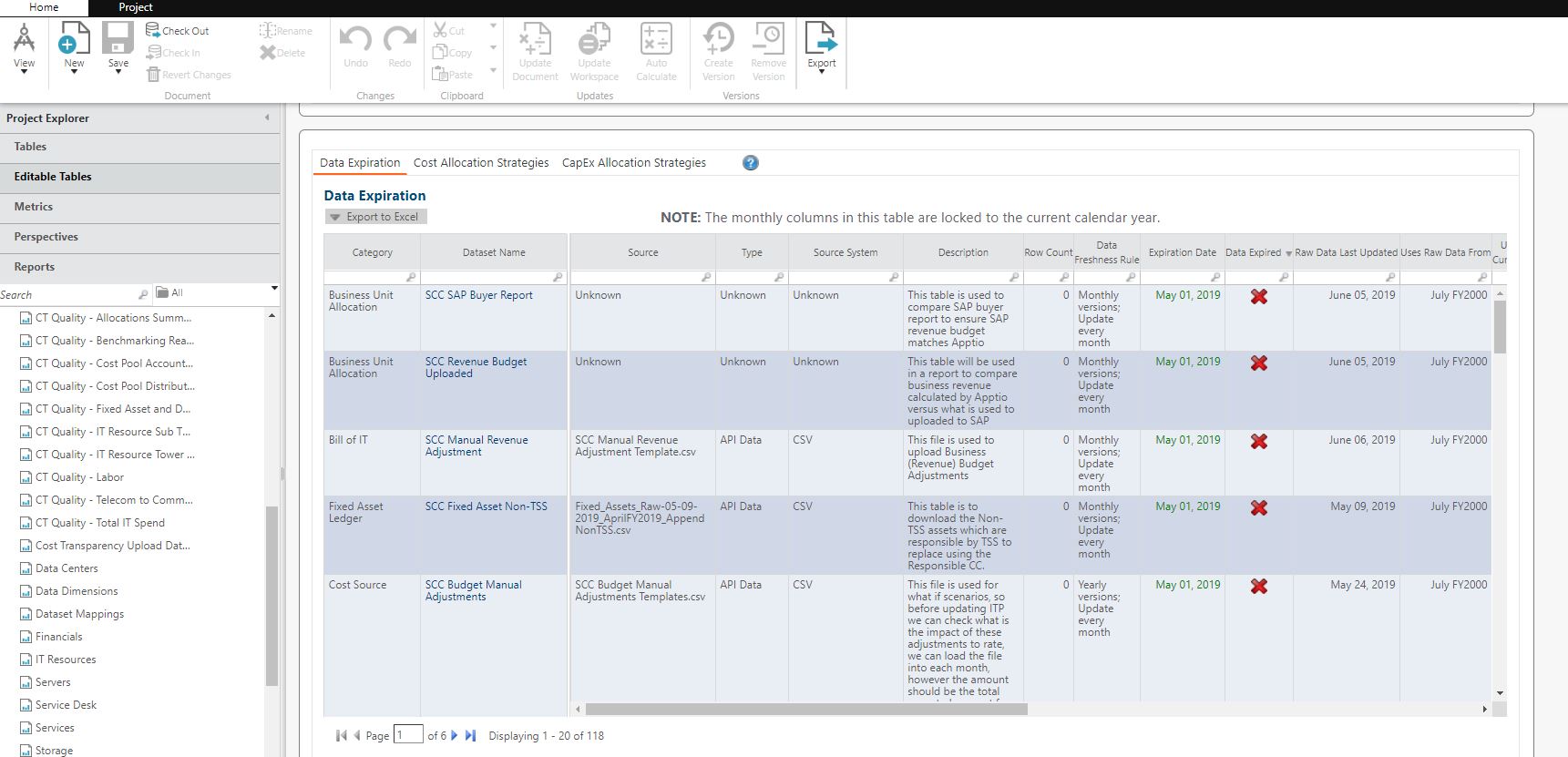

    I found out from our CSM, you can get Raw data last updated information in the report below
    Data Quality/Summary report - scroll down to the bottom of the report, and on the Data Expiration tab, you can see the info
  • 5.  Re: Data upload time stamp
    Posted 07/31/19 02:10 PM
    That "update" date is an indication of when the table's config was last changed...not when data was last uploaded.
