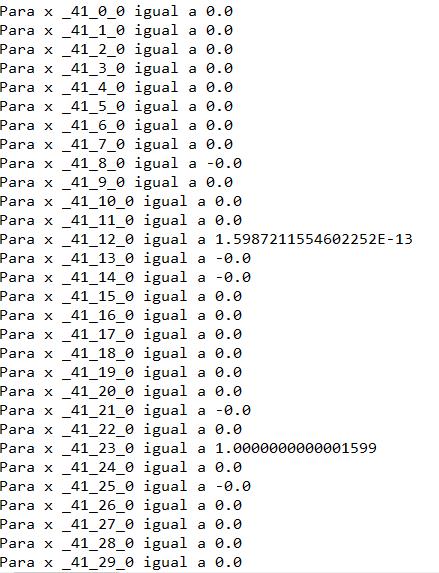

    I have run an instance of a vehicle routing problem with only one vehicle and 54 locations to verify what is happening.
    I have come to the conclusion that the binary variables that I'm using, when they are equal to one they sometimes are really not equal to one but approximately equal to one.
    For instance for the 41st location I stated the following constraint (taken form the resulting .lp file):
    x_41_0_0 + x_41_1_0 + x_41_2_0 + x_41_3_0 + x_41_4_0
    + x_41_5_0 + x_41_6_0 + x_41_7_0 + x_41_8_0 + x_41_9_0
    + x_41_10_0 + x_41_11_0 + x_41_12_0 + x_41_13_0 + x_41_14_0
    + x_41_15_0 + x_41_16_0 + x_41_17_0 + x_41_18_0 + x_41_19_0
    + x_41_20_0 + x_41_21_0 + x_41_22_0 + x_41_23_0 + x_41_24_0
    + x_41_25_0 + x_41_26_0 + x_41_27_0 + x_41_28_0 + x_41_29_0
    + x_41_30_0 + x_41_31_0 + x_41_32_0 + x_41_33_0 + x_41_34_0
    + x_41_35_0 + x_41_36_0 + x_41_37_0 + x_41_38_0 + x_41_39_0
    + x_41_40_0 + x_41_42_0 + x_41_43_0 + x_41_44_0 + x_41_45_0
    + x_41_46_0 + x_41_47_0 + x_41_48_0 + x_41_49_0 + x_41_50_0
    + x_41_51_0 + x_41_52_0 + x_41_53_0 = 1
    This means that the vehicle has to exit the 41st location exactly once, so one of these variables have to be equal to one. However, the x_41_23_0 value is equal to 1.0000000000001599 instead of exactly one (see figure below, igual means equal):
    Since i was checking if the variable is exactly equal to 1 I was not identifying these values.
    Why does this happen and why does the x_41_12_0 variable is also not equal to exactly zero but approximately zero?
    Is there a better way to verify a binary variable value other than the getValue method (I´m using the JAVA API)?
    Thanks in advance
    Pedro Pereira
  • 4.  RE: Cplex doesn't respect constraints but says it has found solution
    Best Answer
    Posted Mon September 28, 2020 04:53 PM
    This is standard with integer programming. Internally, almost all solvers use double precision values for integer variables (including binary variables), and there is always rounding and truncation error. CPLEX, like other solvers, has a nonzero integrality tolerance. In the Java API, its name is IloCplex.Param.MIP.Tolerances.Integrality and its default value is 1e-5. So, by default, any value within +/- 1e-5 of the nearest integer is considered to satisfy an integrality requirement for the corresponding variable.
    When I'm solving a problem with binary variables, I just compare the value from getValue to 0.5 and call it 0 or 1 depending on which side of 0.5 it falls. Barring some serious problems with numerical stability in the model, CPLEX will never give you a value near 0.5 for a binary; it's just a convenient break point for the comparison.
