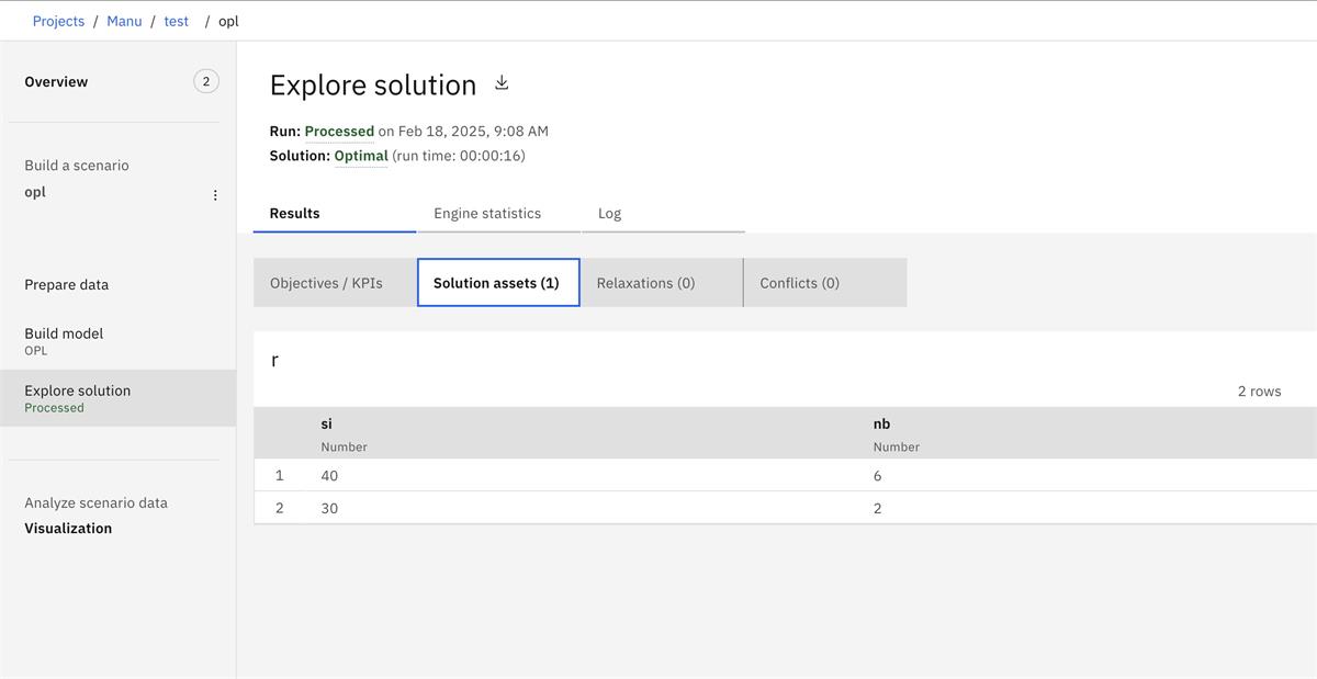

    Posted 12/29/25 03:55 AM
    Hi,
    you need to have your solutions in a tuple set.
    Let me give your an example with the zoo example.
    In the studio within watsonx ai, in OPL you will write
    int nbKids=300;
    float costBus40=500;
    float costBus30=400;
    dvar int+ nbBus40;
    dvar int+ nbBus30;
    minimize
     costBus40*nbBus40  +nbBus30*costBus30;
    subject to
     40*nbBus40+nbBus30*30>=nbKids;
    tuple res{
        key int si;
        int nb;
    {res} r= {};
    execute
        r.add(40,nbBus40);
        r.add(30,nbBus30);
    and then you will see
    [Alex] [Fleischer]
    [Data and AI Technical Sales]
    [IBM]
