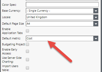

    hi Julie,
    In v11: If in your project settings you have Cost Model as your base model, any modelled metrics that you create will be base on that model using all existing allocation lines.
    If you have a model that is out of date compared to cost yo need to:
    • Not the initial drivers
    • Delete the modelled metric
    • Crate the modelled metric
    • Update the drivers

    In v12 things are much better. It is just a case of ensuring that the metric is selected in the relevant allocation lines.
