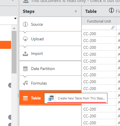

    Hi Gordana,
    When you say that you've created a transform, is this the way you went ahead and created a transform ? The below mentioned step creates a new table which is based off the existing table, ie with the new columns added.

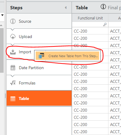

    You can also create a copy of the table at the Import step also. This is, if the case is where you want to have a copy of the table loaded into Apptio without the new columns added in:

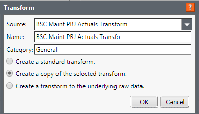

    thank you for that.  But what I have is a transform that I created in order to do some data filtering etc.
    Now I need almost the same transform with some minor changes.  Creating a standard transform from it won't work because I actually need to be able to change some data filters on it and when you do that those are not available to you.
    So copy would work great because I would have the same transform I can then modify how I need to.
    This is the option I am talking about:

    Hmm, Yeah, I think this is lacking in R12. The currently available option in R12 "Table off Existing Table", is I believe the "Create a Standard Transform" option that we had in R11.
    I believe this should be a feature in their upcoming releases.

    You're both right.
    In R11, "Create a copy of the selected transform" only works in certain cases (depending on whether the source transform comes from raw data or from another transform).
    In R12, we don't currently have a way to copy a transform with all of its pipeline steps to a new separate table. We can copy the results of the source table's pipeline steps, but not the steps themselves.
