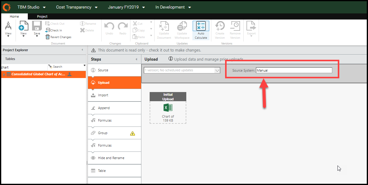

    Our TBMO discovered changing the 'Source System' field for an existing table inadvertently creates a HIDDEN version.
    What I mean by "hidden" is that there's no indication of a version created/active.
    The problem with a "hidden" version is that you wouldn't know a subsequent change (after the "hidden" version is active) made to the table is NOT applied to other time periods.
    Here's how we stumbled on the issue:
    @Richard Coronado updated our Global Chart of Accounts table's 'Source System' field to better reflect the data source.
    Later, a new GL account was added and subsequent data file uploaded.
    On performing some QA checking, @Richard Coronado discovered the newly added account appeared from start of time to Nov FY19, but not in Dec FY19 and beyond...due to the "hidden" version in play starting Dec FY19.
    Please be VERY careful when changing the 'Source System' field for existing tables!!
    If you encounter this, too, please reference our case 147121.
    Source System field
