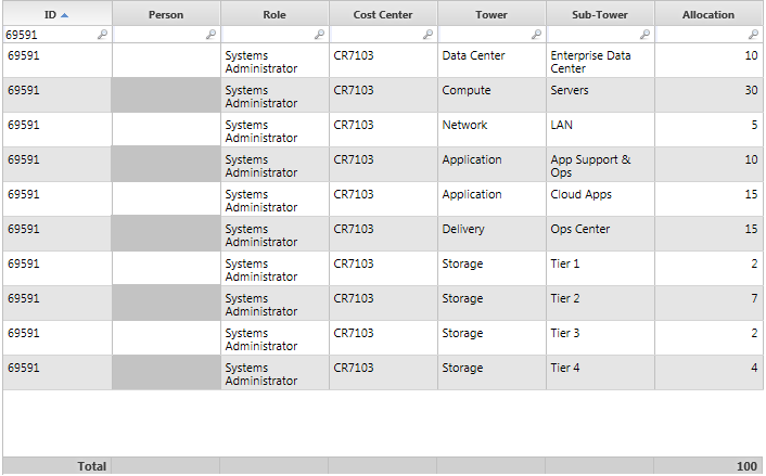

    Not sure if this helps but we map every labor headcount (internal and external) to towers directly and then have an allocation amount against each - this is also done for vacancy positions too.
    It's a little cumbersome at the start of a financial year (especially as we have changed our departmental structures a few times over the last 2 years) but if your headcount is stable then you don't have to update the mapping too often.
    Example below:
    Labor to Towers Example
