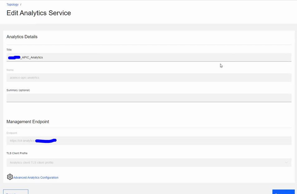

    Hello Experts,

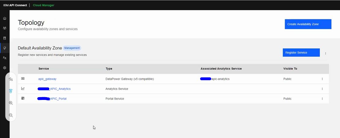

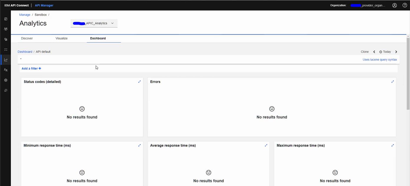

    We have successfully installed APIC v10 and all the management subsystems are up and running fine now but we are not getting the analytics data in APIM analytics.
    All the DNS are checked and its working as expected
    TCP connection is working from Datapower to Analytics ip and host name over 443
    We have tried removing and adding back gateways in cloud manager.
    Below are the few doubts I have and need clarification on that.
    1. We have defined analytics-client at the time of ISO creation so we are using internal storage. Is there any way to check and confirm this ?
    2. We have not defined internal storage space before deployment of analytics subsystem, Is it a requirement and can we define it now ? If yes how can we do it ?
    3. Do we need to create analytics-extra-values.yaml file and define anything on that ? or that's optional ?

    Thank you for your response, Issue is resolved now by adding analytics-client and analytics-ingestion in DataPower host alias.
    Yes, We have installed with VMware and not enabled message queue for this installation.
    If possible please let me know why it was required to add analytics-client and analytics-ingestion in DataPower host alias ?
    If it is required and mandatory then its not mentioned anywhere in the Documentation which we followed.
